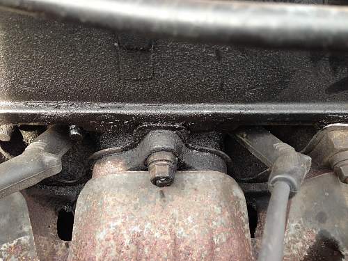

    My 1988 Honda Accord DX has 168k miles on it. Recently, on one or two
    occasions the car has started but due to the cold New York weather has
    decided not to heat up. Eventually the idle grows so poor that the car will
    just stall out and attempting to restart the car after this is basically not
    happening. However, it is not the thermostat that causes these problems
    as I have replace that along with other parts that I felt might have been
    to blame for this such as the spark plugs, wires, the distributor cap, rotor,
    and the radiator.

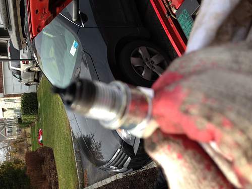

    I have also noticed that the car's exhaust smoke is white
    with a hint of blue if the car is revved. As I said before, I replaced
    the spark plugs and wires recently (about a week ago) but today
    when I opened the hood to look around it appeared that oil was
    leaking down the engine and a removal of one of the sparkplugs
    verified this as it is charred black. I will enclose pictures below.
    Does anyone have any words of troubleshooting wisdom for this
    situation? I just hope that the car wont have to be laid to rest
    but putting money into something that in the end would not be
    worth it is out of the question for me at the moment. I also dont
    want to spend a grand sum of money only to find that the offending
    part was an old gasket or O-ring of sorts.
    Help please! and thanks!

    do a compression check. If all cylinders are about the same put some new plugs on it. Check that the choke is opening as the car warms up. You may want to try jamming it open a bit
    Eric
