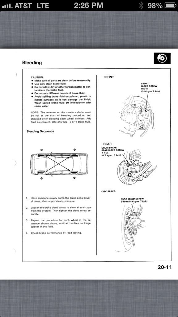

    Hmm okay, so ill probably just visually chek out the calipers then, and go ahead and just grab me a m/c. So I'm going to assume its the same as changing the brake fluid except taking the brake lines off first and unbolting the cylinder bolting the new one and reconnecting the lines and wires filling and bleeding till no bubbles and clean fluid? Any tips or tricks I should know? I got both the Haynes and Clinton manual as well as a copy of the service manual on my laptop! Much appreciated and merry Christmas!

    Before buying the master cylinder I would at least do a full brake bleed.
