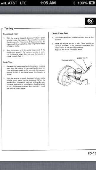

    Re: Idling issue, please help!!!!!
    Here is the procedure for testing the brake booster.
