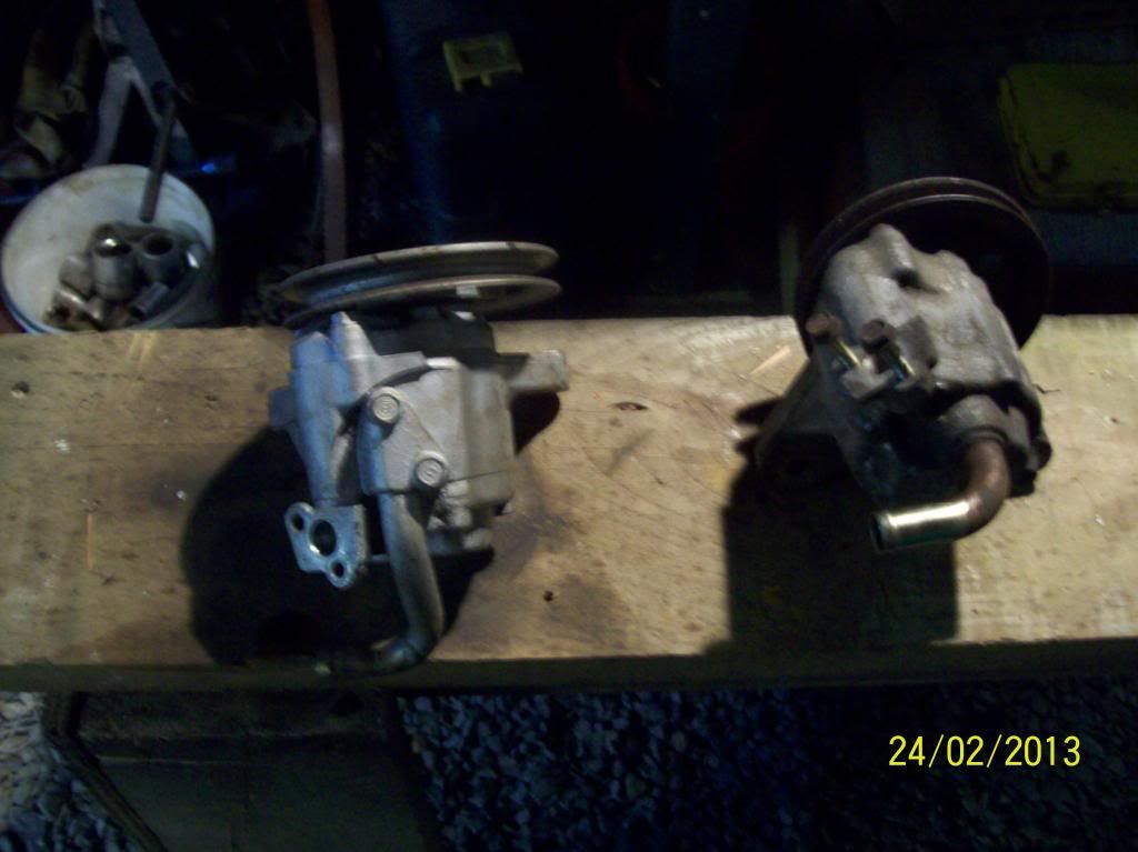

    Well I got other pumps laying around,4 or 5 I think.If it warms up I'll try swapping one,does anyone know why some of the pumps the return neck pressed in the pump and some bolt on like the high pressure line.
    Re: Power Steering Leak
    I wasn't aware there were any differences. Can you post pics?
    Here u go Snooz.
    Probably OEM vs. aftermarket design or something, one on the left looks like OEM
