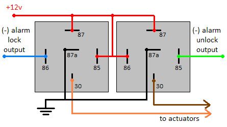

    You really need relays, to make this work right, ill send. You a basic diagram on how to set up two bosch type relays to reverse current, ill have to do it a bit later though, those mercedes power seats can pull a lot of current, so you really need to use relays
    Re: need help finding some switches
    You need a switch setup with a single pole double throw, the center pole goes to ground,then you have two seperate ground outputs depending on the direction the switch is pushed, use the same diagram here you would use for door. Lock actuators,except the motor replaces the actuator.

    it would require 2 five pin bosch relays per motor,which you can get all day at the yard, from working on those old mercedes power seats in the past, they requre a shitload of current, its going to be hard to find a switch capable of handling it, a lot of full size american cars with power seats had a relay setup already mounted on a bracket and wired

    almost every power seat setup ive seen has had relays, they often use series wound motors which take a lot of current, even if you used a switch by itself, it's going to shorten it's life considerably

    A lot of those seat motors can pull up to 30 amps
