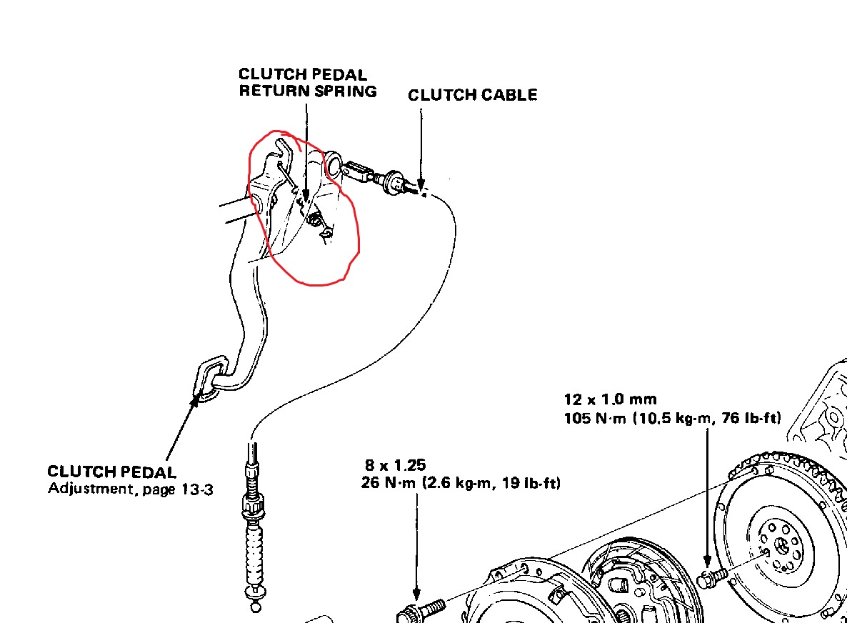

    So, about a week ago, i parked the car, nothing out of the ordinary had been happening, but in my drivers side floorboard laid a circular spring i could see had broken. No clue at that time where it came from and didn't think anything about it having came off my car, well, today, i think i figured out where it belonged. The past 4 days now, my clutch pedal has been really hard to push and it makes this terrible metal on metal like sound when pressed. And shifting into gears is now a matter of brute force alittle over half the time, like trying to shift your car while it's shut off in neutral without the clutch, sometimes it doesn't wanna go into first gear, but it's like that in all gears now. When i stop at a red light, and finally get it to shove into first, it still pulls alittle like an automatic when you're stopped and let off the brakes and it slowly starts to move without pressing the gas, and that's with my clutch fully depressed to the floor, all the way. I tried tightening my clutch cable adjustment as tight as i could without going overboard and it still does the same stuff. Could my throwout bearing be going out? Clutch is fine, once it goes into gear, it doesn't slip or anything. Could this small circular spring be the issue cause it to be hard to shift from neutral into any gear? What do you think may be causing it?

    Sounds like your clutch fork is about to break. Not sure about the spring though.

    could the clutch release fork be the part you're talking about? I couldn't find a clutch fork in any part of the entire repair manual.
    As a side note, this is an A2K5 Prelude Si trans, But i still have my original A2Q5 stock transmission even though 5th gear is down for the count, so hopefully parts are transferrable per transmission that i need.

    Stick your head under the dash and see whats up with the peddle linkage. It sounds like the cable is not pulling far enough too release the clutch.
