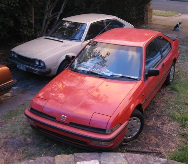

    Well I Don't think I ever got around showing my '88 Integra project here:
    http://www.cardomain.com/ride/383532...honda-integra/
    Hopefully it's been nearly sorted for a year or so now, & staying at my parents place until it's 25th birthday in August when it will qualify for cheaper classic/historic road registration for occasional use (since '79'cord still does daily duties). Though clutch now needs replacing & paint is now even more faded than before.
