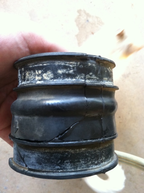

    i had a crack in the coupler on my air intake. the part i need has been discontinued. ive called dealerships and autopart stores and looked at every possible online store i could find. please please please if anyone knows how i can jimmy-rig a new piece of (something) on there please let me know how i can do this and what kind of material i need to use. thanks guys!

    Re: Any easily modified Cold Air Intakes for the LXi?
    thats for a stock intake not a cold air intake....
    prolly gonna end up being a jy part but you could also just rig one up with the proper size rubber tubing and a couple hose clamps

    Quote Originally Posted by cdxxprincess View Post
    i had a crack in the coupler on my cold air intake. the part i need has been discontinued. ive called dealerships and autopart stores and looked at every possible online store i could find. please please please if anyone knows how i can jimmy-rig a new piece of (something) on there please let me know how i can do this and what kind of material i need to use. thanks guys!
    Just get something like this, they are called intake couplers. You will probably need to get some adjustable hose claps to replace the factory ones. Next time start a new thread, or find one more closely related to your question.
    Intake Coupler | AutoZone.com

    my bad. i realize now that i was taught all wrong...with the names of things. I'm new at this whole car thing. but i did end up finding that part in the junkyard. there was only one...out the hundreds of hondas that were there. and luckily it was in good shape. i snatched that thing up!!! and it will do until i can afford to modify my intake system...
