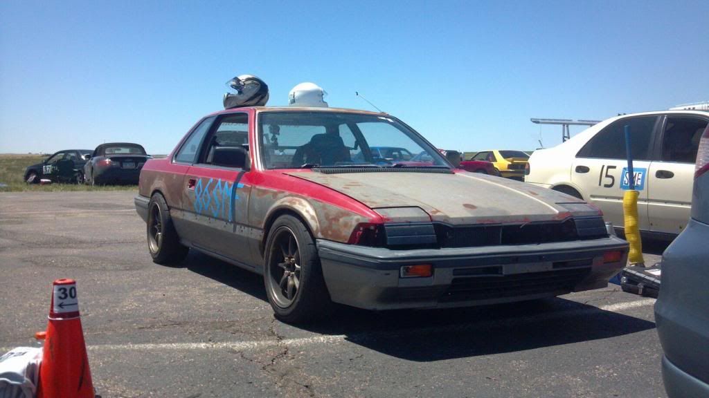

    So I've previously been very active in the solo2 scene with the SCCA and now after 2 years i'm trying to get back into it... Figured I should start posting in here to try and bring some attention to the "ugly ducklings" of this site, IE the classic preludes! One of the saddest things about guys that race, is that so few of them who are good actually post about there experiences. We'll I'm here to try and get active again, and I want to try and be active in this portion of the forum as well, as I fell that I can help several individuals on this site get into SCCA racing...
    here is a little intro video to give you guys an idea of what we are working with

    Here are some results from the last few races...
    So I can't pull up the link for the individual events, but here is a link, and i'll supply the dates to look for in the drop down...

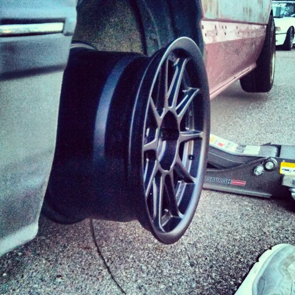

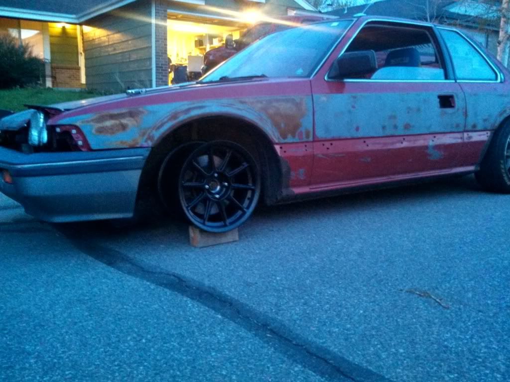

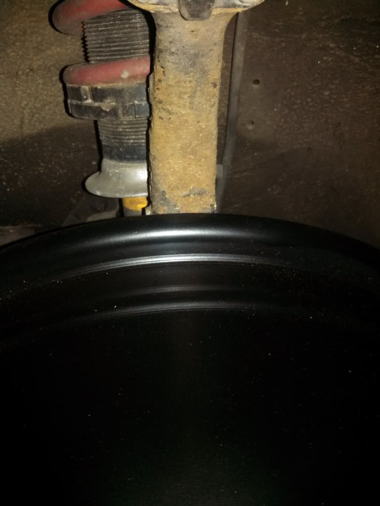

    Got some new wheels for competition too btw... Here are some pics...
    15x9 TrMotorsport wheels
    Needs like a 15mm spacer I believe to clear everything...

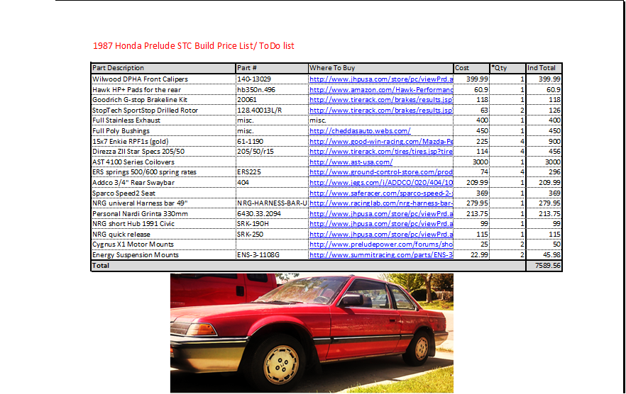

    Ive been poking around in the rule book yesterday, and it turns out that you can you use any braking components that directly bolt on to the factory mounting locations!!! So I may have found something super special!! Here is my to do list for the next year...
    Get head repaired and shaved to minimum thickness (300$)
    Get a cheap paint job to fix minor body issues (<1000$)
    Full exhaust (header back!!) (<600$)
    All new poly and derilin bushings (400$)
    15x7 wheels (I currently have a set of Kosei K1s) (0-900$)
    Badass class specific tires! (600$)
    AST 1 way adjustable shocks (custom) (3000$)
    Custom Spring rates with perches (thinking my usual 500/600) (400$)
    Addco Rear sway bar (250$)
    Poly mounts for stock front Sway bar (<50$)
    1st gen integra rotors front with 89 sei accord calipers and hawk hp+ pads (<200$)
    Si rear calipers with hp+ pads rear (<150$)
    Goodrich Stainless Steel Lines (100$)
    lightwieght seats of some sort (<1000$)
    harness bar (250-400$)
    stroke as much power out of the carbed motor (???$)
    smaller steering wheel (hate the base model steering wheel) (<500$)
    Cygnus x1 motor mounts! (forgot to add)
    That totals upwards of 10k on the high end!!! Damn, but the good news is, that what one moton set costs for one of the STC civics thats already running!!! So we ready to do this?

    So I got my 9" wheels, my 15mm spacers, my 275 hoosier A6s, and my 949 racing lugs/valve stems... The new lower ball joints, new wheel bearings and extended lug studs are all installed... just gotta get my tires mounted on my 9"/8" staggered tire setup!!! I'm super excited!

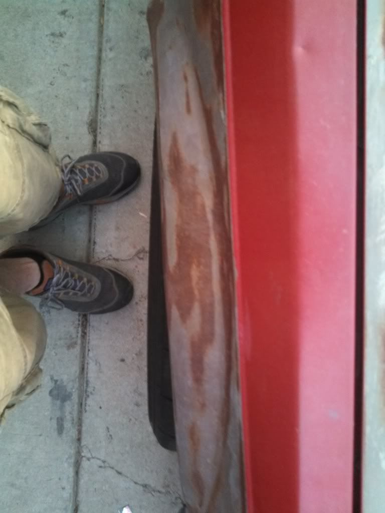

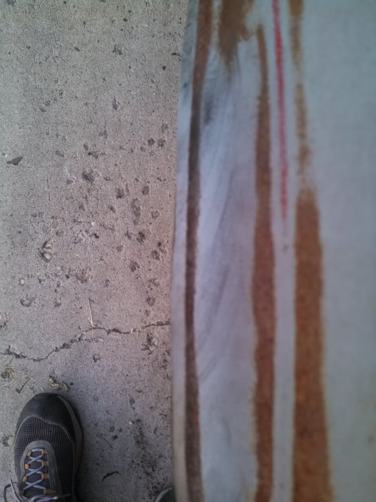

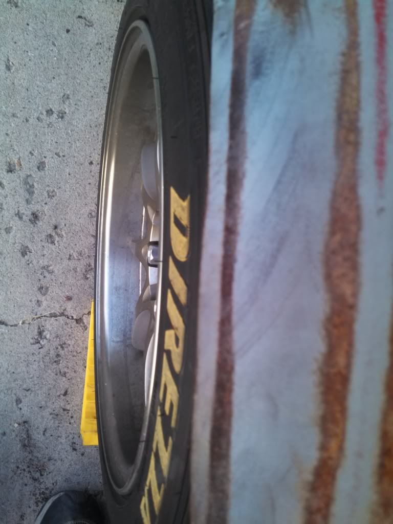

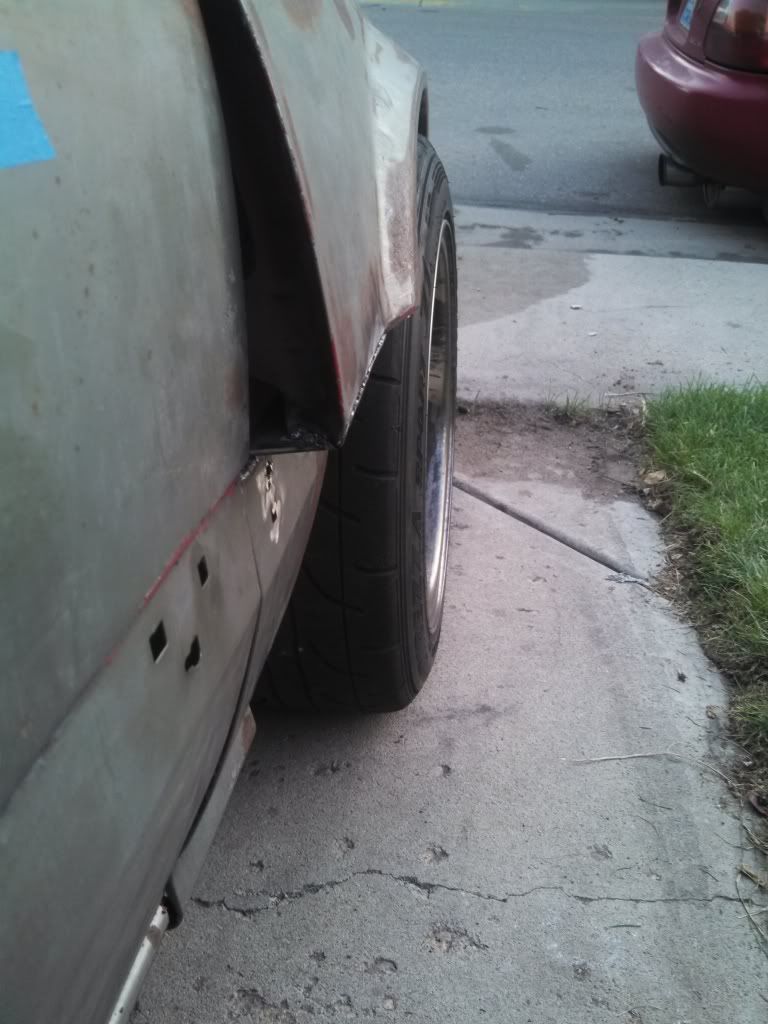

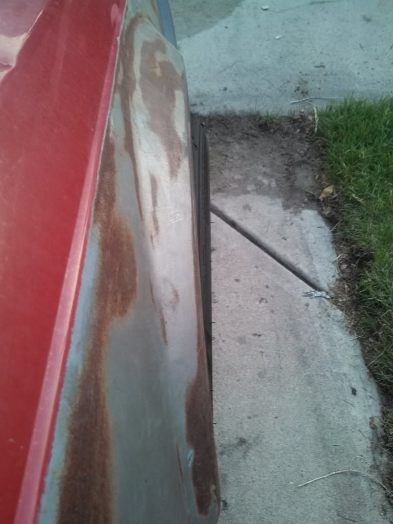

    alright, so it takes a serious amount of fender massaging to get the big ass tires inside the fenders or an 86 prelude with as low as I am... These pictures will more than likely upset several individuals... Lets just call this EXTREME tire clearancing...
    Here is a picture from the last race for shits and giggles...
    First the fronts...
    Stock look with 15x8 +25 and 205... no Spacers
    the same wheels with a 15mm spacer... (keep in mind i'm going to be running a 15x9 and with a 275!!)
    No spacer...
    Think thats bad, cutting the fenders then welding in a 2x2" 1/8" steel, wait till the next post...
    LXi User hondalude86's Avatar
    Dec 2003
    1986/Honda/prelude si
    Denver Colorado
    731

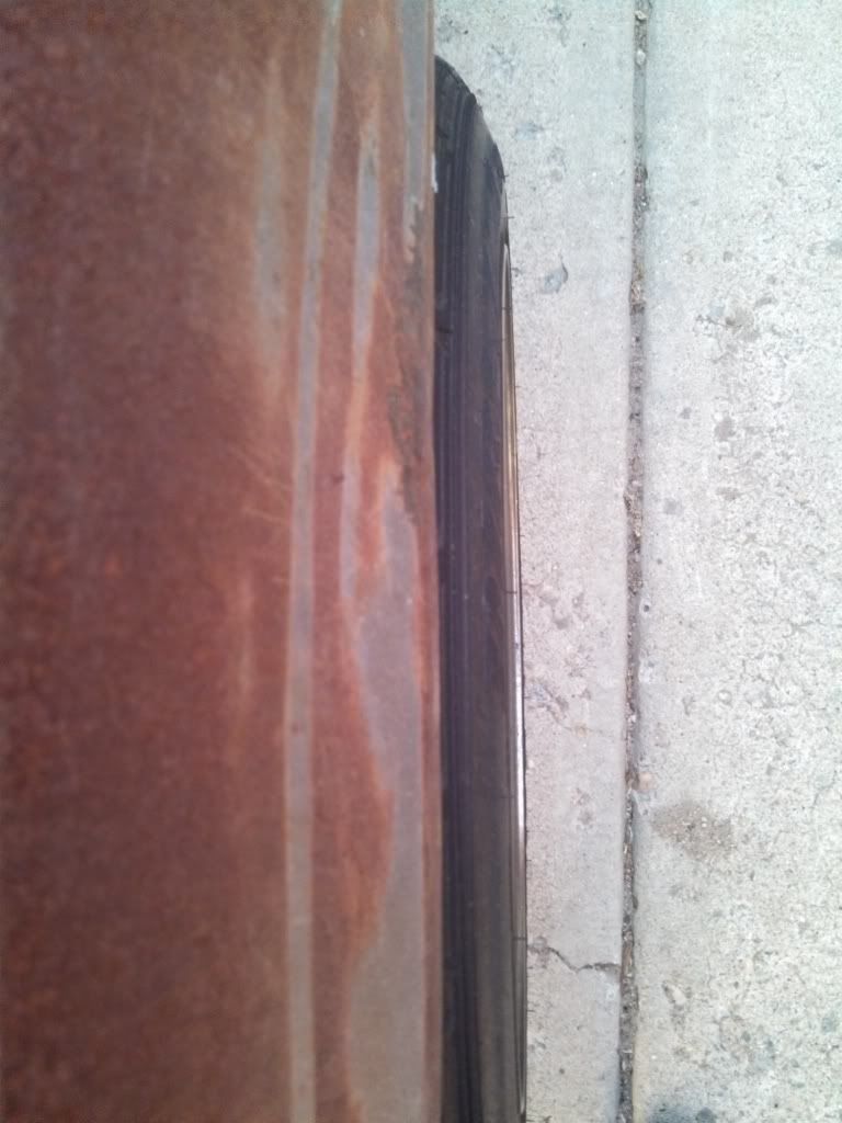

    Re: AB solo2 car...
    More front molestation...
    nice, flat oem fender lip...
    completely butt fucked, cut, stretched and flattened fender!
    before...
    after!!!
    I think i've got enough clearance for my tires... but the rears? stay tuned...

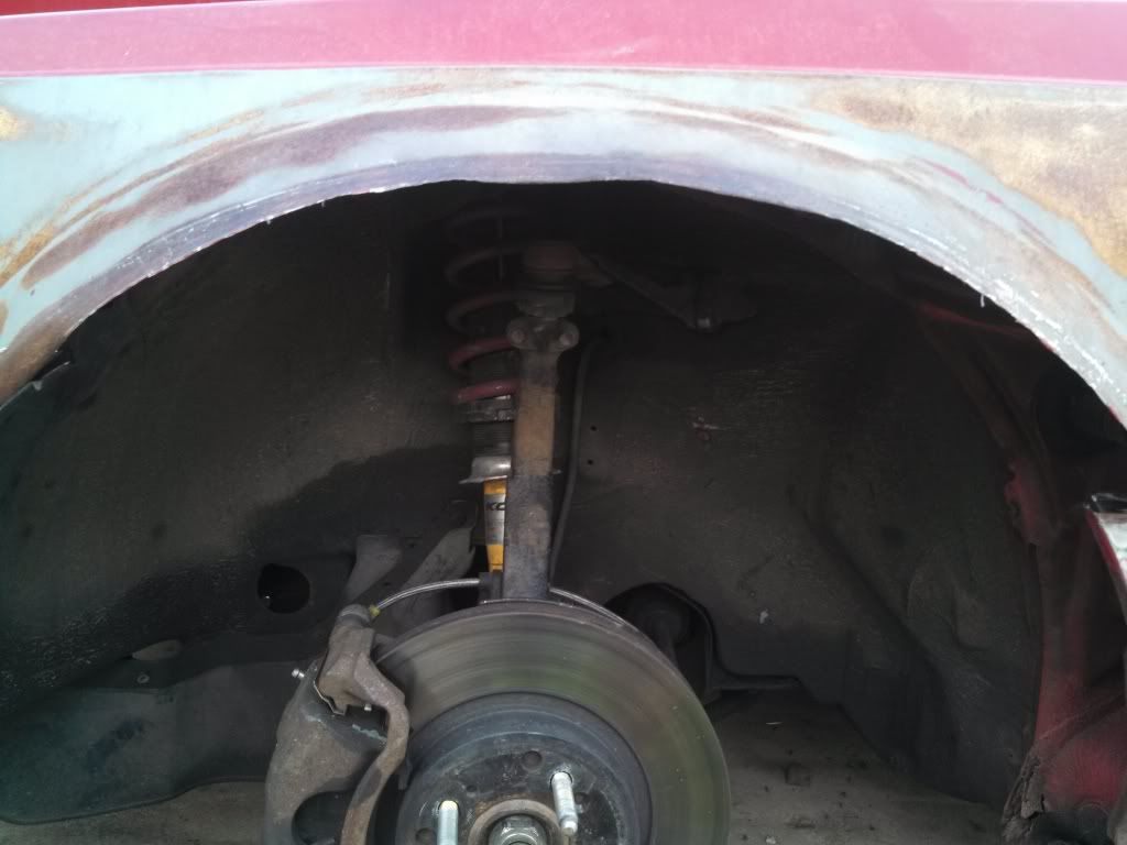

    Re: AB solo2 car...
    now for the rears...
    before...
    after!!
    yes, there is a wheel in there!!! lol
    Now keep in mind for the rears, all i need to fit is a 15x8 +20mm with only 225 hoosier A6s! whats it look like with the race tires? Stay tuned!!!
