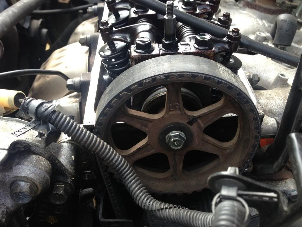

    I have found and lined up the T mark on the flywheel! I removed the timing cover and this is what the cam gear looks like, I have lined it up with the cam cap groves. This is how it is without having me change anything. Dose it look straight to everyone else on the form?

    And I can't tell at the pic angle if the two dots are even with the top of the head but it basicly looks close.

    Quote Originally Posted by massiveheadake86 View Post
    Cannot tell from that side. The marks are on the back of the cam gear and should line up with the edge of the cylinder head.
    The manual shows the marks in the valve adjusting section, better than it shows them in the timing belt section.

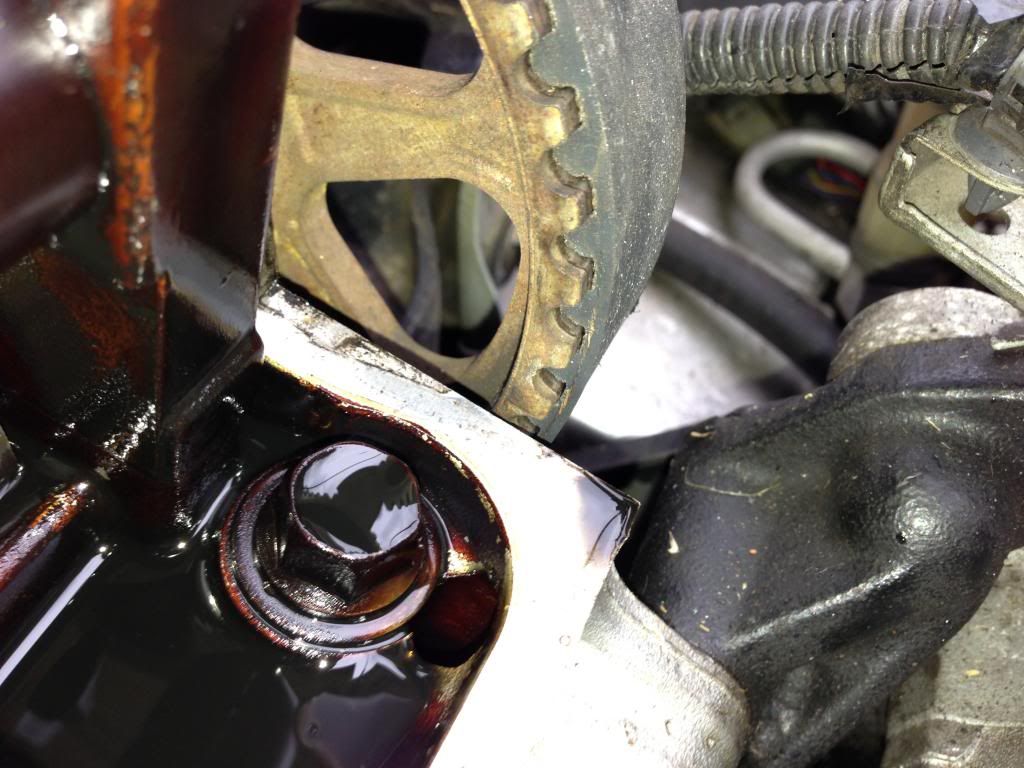

    Re: 86 accord wont rev up?
    I can clearly see the timing mark on the back of the cam gear. Dose this mean mt T belt is on correctly?
    The cam gear sitting like that with the T on the flywheel lined up with the timing mark is on correctly.
