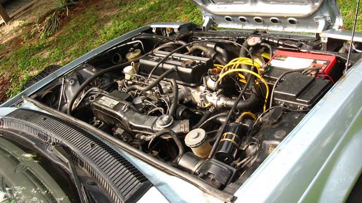

    Those stupid plug wires piss me off but oh well that can wait!

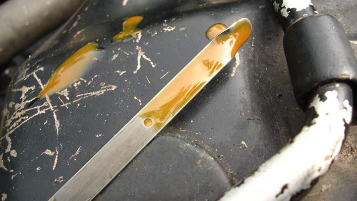

    Oil after 20 mins run, mostly idle. I only did one flush after the second headgasket job and it stayed this cloudy so its definitely good now! I'm going to flush out the oil again and hopefully it would stay clear this time! Any tips/tricks to fully get the old white stuff out?

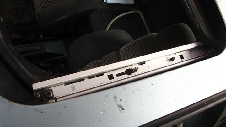

    Also cleaned the sunroof tracks when I had the sunroof checked since it was leaking like mad. The glass doesn't sit flush with the roof. Ended up adding a couple of washers about 3-4mm thick ><

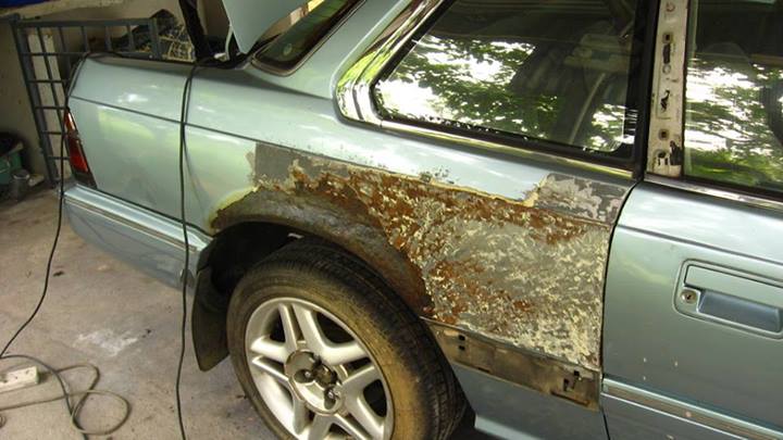

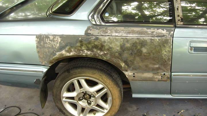

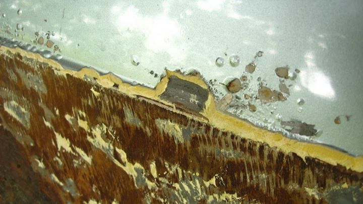

    Done quite amount of work since last week. Decided to fix the quarter panel rust.
    Stripped the 312321321 inches thick of filler
    ooookay looks like they decided to add a bunch of filler to fill the line and made a new one out of.. filler. wtf really?
    All gone

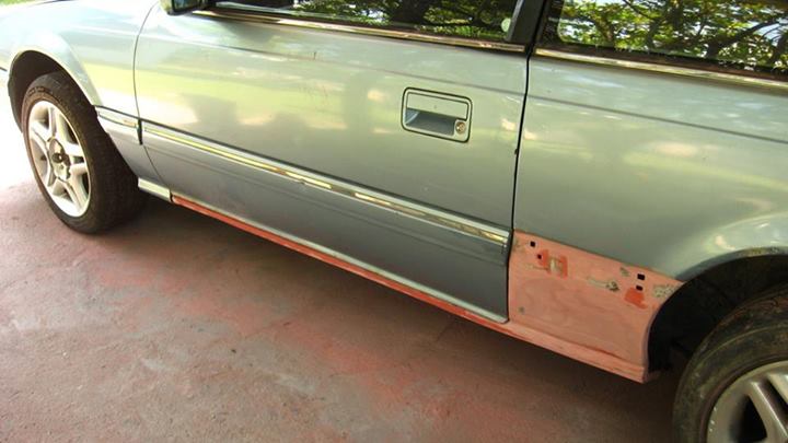

    Added a bunch of filler. Not as thick as the old one though

    It was a bitch to shape the wheel arch line though since the original line is non-existant. This is not the best way to do it but finding a replacement quarter panel is going to be.. impossible. The next best thing I could do is to weld new metal on, probably cut from front fender or something but then I have no welder
    Passenger side has a bunch of filler on the rocker panel too -.-

    Both quarter panels has been hit before. I'm guessing they sideswiped something on the right side since the fender and door came from a red car. Can't be sure about the left side though. Door is original, at least I thought it is but the quarter panel is trashed. I don't feel like doing that side yet.
