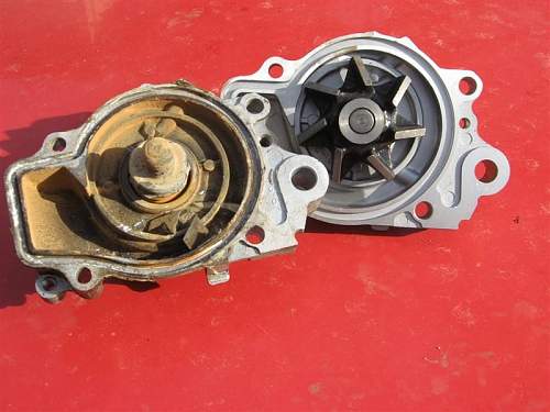

    Obvious question is to ask if cooling fans are actually coming on since the thermoswitch in radiator can fail (bypass to run fans constantly by connecting the two wires to it).
    Less obvious might be waterpump. When bought the one on my '88 integra had rusted its impeller blades completely off, rusty sludge everywhere & radiator had already been replaced.

    Integras water pump mentioned earlier:

    Keep your eyes open for some 3g Civic or Honda City 'H' bearing caps for the center of those wheels (much nicer than covering the wheel nuts I think).

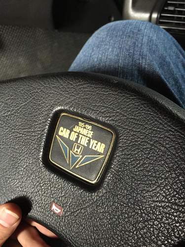

    I was getting an alarm installed today and took advantage of the time and put in this badge Aaron sent me aaaaaaaaaaaages ago. Looks good. Might take it off again and try clear coating it. Definitely needs it but I'm apprehensive as to whether it'll work.
