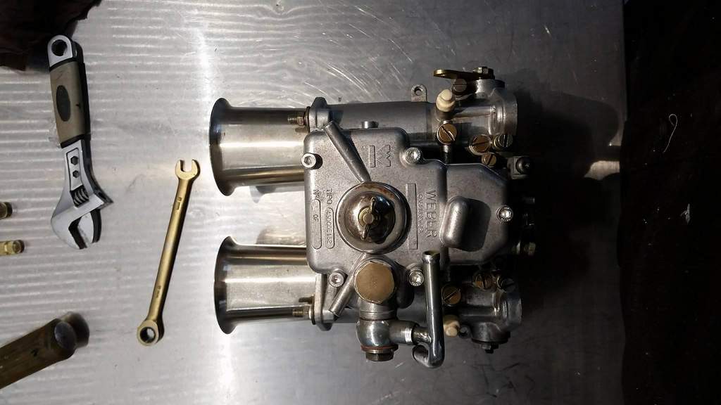

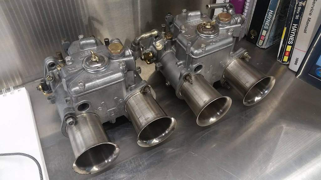

    Webers are fully rebuilt now and cleaned up. They came out amazing !!! So shiny
    Pistons are in too... so much shiny !

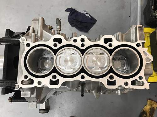

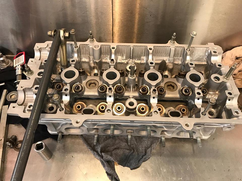

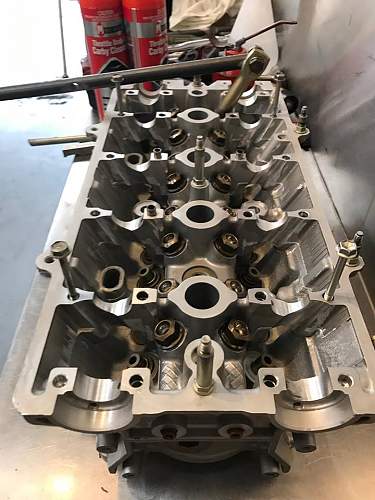

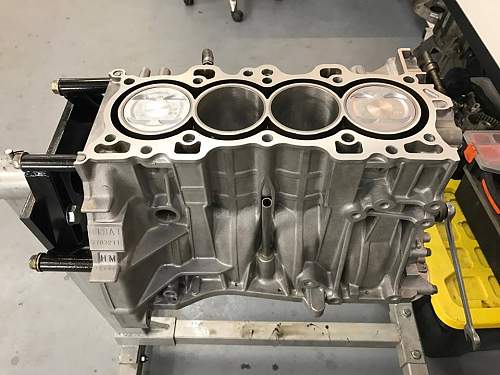

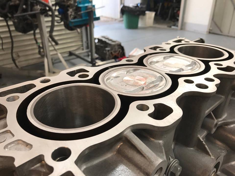

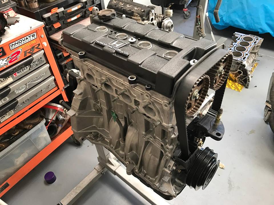

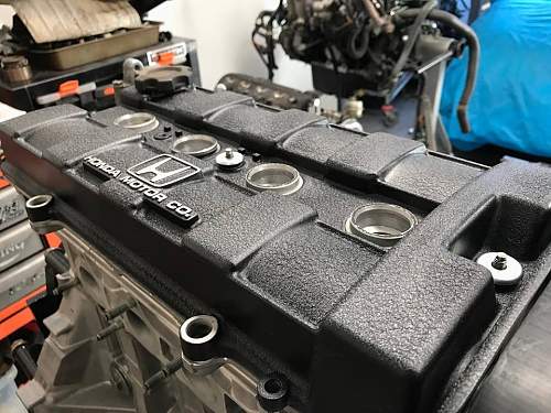

    Some more progress ! Engine is back from the machine shop.
    So. Damn. Beautiful.
    Some shots of the block.
    And here's the head.

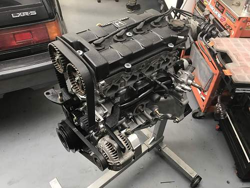

    It's almost go time !

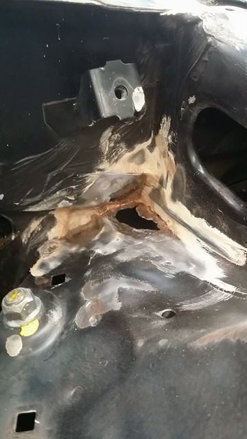

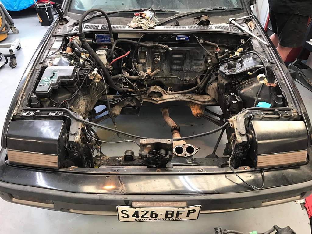

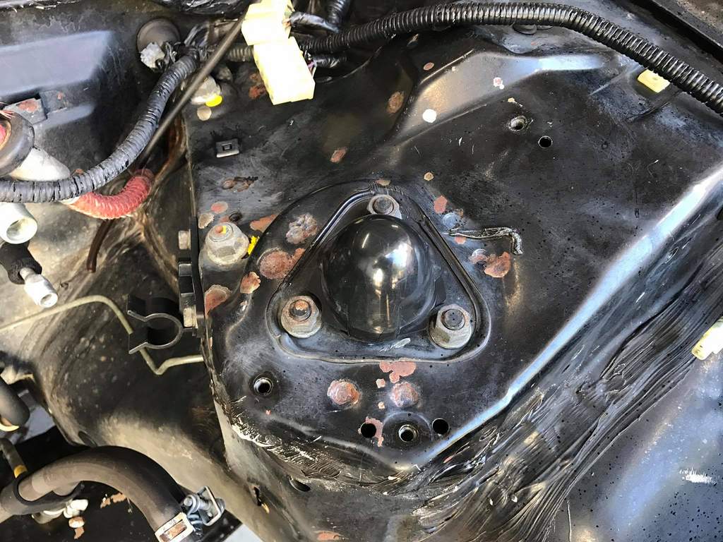

    The engine is out ! We started cleaning the bay and found out there were little rust spots dabbed everywhere which blows. Cause of repair and respray !

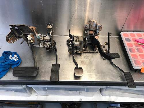

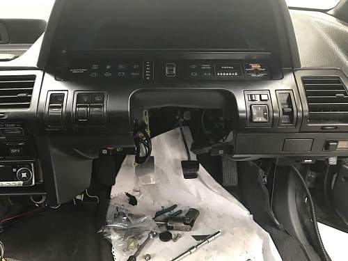

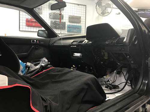

    I spent quite a few hours down at the shop today. Lots more has been removed. The driveshafts are gone too and will be replaced with 2 from the DA model Integras.
    We also took out the pedal box. We were hoping the one out of the donor DA we got the engine from would have the same mounts and we could bolt it right on however unfortunately when we took out the one from the Aerodeck it was different.
    There's also an extra linkage for the cruise control which we'll remove before we put it back in. To save fucking around we decided to just cut and paste the clutch pedal from the DA. We're also fabricating custom aluminium pedals.
    I like these. The 'Go Pedal' is a bit larger than the original Aerodeck one. As you can see the design of the pedals has actually brought the accelerator and brake closer together - ergo, easier heel and toe.
    We found some custom engine mounts on a website that would allow for plug and play (essentially) when changing the engine but they wanted $700usd for the mounts plus $800usd for shipping. I spat the dummy so we decided to make our own. I won't name the website but I honest to God hope they were joking with the shipping quote.
    Our mounts should be done over the weekend, but more on that later.

    A few more things have been added to the engine.

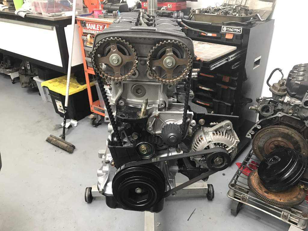

    I ordered the adaptor plate for the Webers last night too. Turns out the guy who was going to make mine 3 weeks ago still hasn't so we told him where to go.
    The new one should be here in 2-3 weeks and then we'll have engine porn gifted from God himself sitting in the shop.

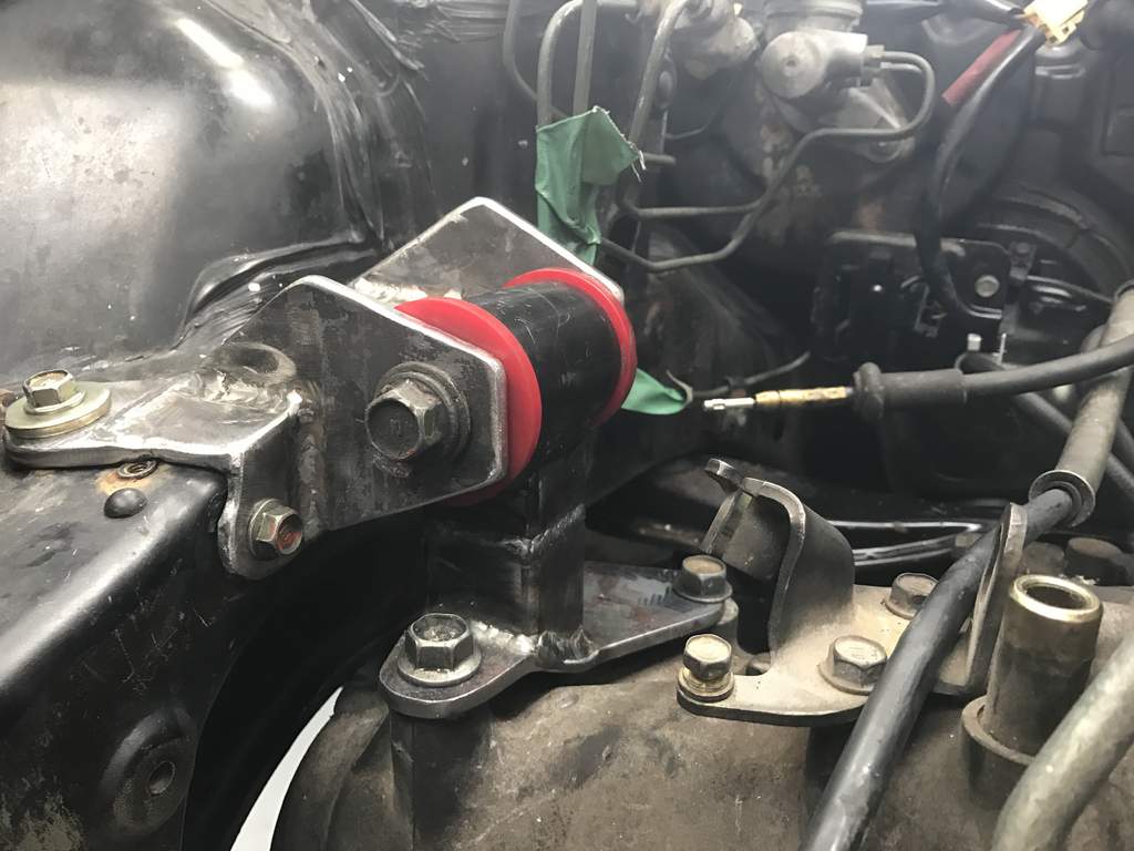

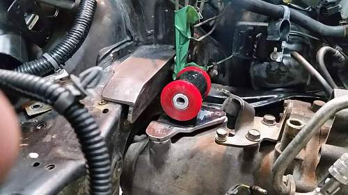

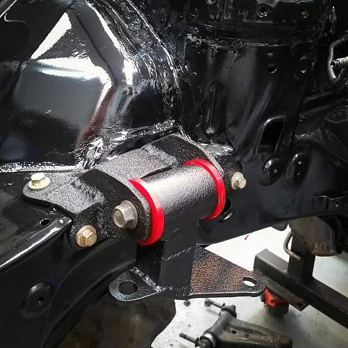

    Engine mounts are all done too. They look fucking sick and still need a bit of work. But they took the weight of the engine without any rocking, knocking or moving. So a fresh lick of paint and a few adjustments they'll be perfff. All mounts actually use existing holes on the body which is wicked.
    ^ Driver's side. Remember: my car is RHD.
    ^ Rear
    ^ Passenger's side

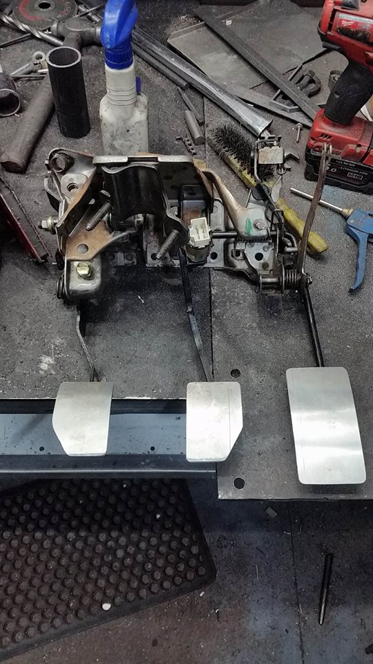

    We also tried out that pedal box too. It fit well however there seems to be a mount on the body/firewall which stops the clutch pedal from being pressed further than half a compression or so. We suspect it's a mount for the factory manual pedal box. It sticks out about an inch or so. That will get the chop.
    3 pedals suit this car.

    Bit of rust uncovered in the bay. This is just one of the cancerous spots. Will be cutting them all out and welding a new piece of metal in before paint.
    Here's one of the mount brackets in wrinkle black. Looks so good !

    Here's a picture of the contrast in textures. Looks the goods, that's for damn sure !
