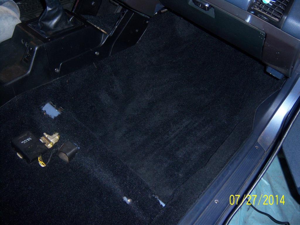

Don't remember the brand. Will have to find the receipt. The mold they used didn't have the ducts that run down under the seats. Little work with a heat gun fixed that. Other than that, the rest fit perfect. I got it with their "mass backing" option. Helped a lot with road noise. Its a lot thicker and heavier than factory.
This is where i got it 86-89 Honda Accord Carpet 2 Door or Hatchback 1986, 1987, 1988, 1989
None of the holes are cut out and all of the edges are too long and have to be trimmed. But it fits quite well. I got the ultra plush with the mass backing. They will also send you samples so you can see/feel the difference and match colors.

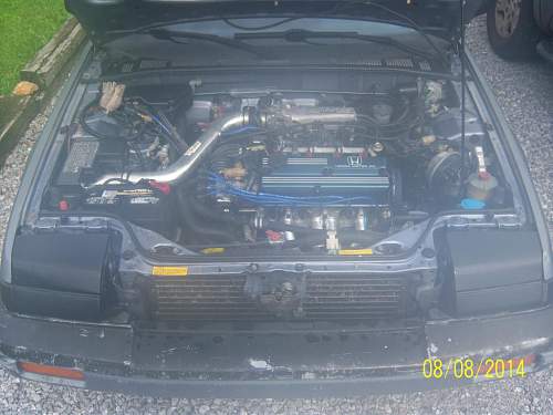

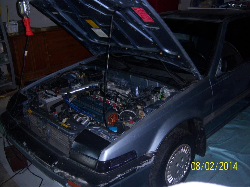

Finally back on the road. Trans is a little rough. Hopefully its from sitting dry for the past 5 years and will smooth out as I drive it more. Pgm-fi came on with code 12. Will not idle if A/c is on. So I still have a bit of tinkering to do. But it made it to and from town (15 miles each way) with no major issues. Basement seems huge without the car in it lol.
Not sure if someone wants to add this to the 5speed swap how to. But, I didn't have to ground the pink wire for cruise to work. I had a plug dangling under the dash already for the clutch switch. Plugged that in and cruise works as its supposed to. Turns off with brake or clutch.
Got a few more things done. Replaced one of the small coolant hoses on the intake(had a pin hole in it), replaced egr valve(still get code 12)(Solved, clogged vacuum chamber), and adjusted the idle. Still likes to die at idle with a/c on sometimes. Not as bad as it was tho. Next I need to track down a battery draw. Brand new Diehard gold battery goes dead after 2 days of sitting.
