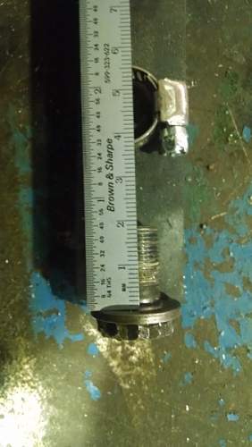

    Have you or anyone tried this out to see if they'll work?? If so I'm interested. Same thread, head size, length and 12 point?

    Have not tried them yet. Waiting on money. According to part #s on majestic Honda they should be the same. Looking at pics the flywheel bolts are 12 point and pressure plate bolts are 6

    Here's a picture from my car 1988 LXI 5 speed.
