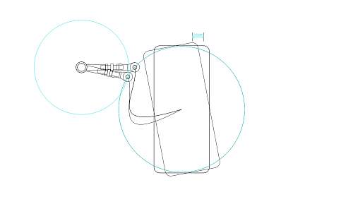

    Doing some costing here to see what you guys would prefer for the rear adjusters. The product including new ball joints, allowing for +0 to -6 degrees of safe negative camber. (can be adjusted to -8) What material should I build them from? I also want to note that you will never have to buy another stock ball joint. You can simply replace the rod end ($20 a side) when they start to wear. I know you can get them from Moog, for less than what I am offering, but they don't have nearly the same about of adjustabilitly. Plus when one goes sour, you have to replace the entire thing. My part is designed to use Energy bushings, and Standard Rod ends, which means they could last a lifetime. All parts would have TIG welded flanged joints.

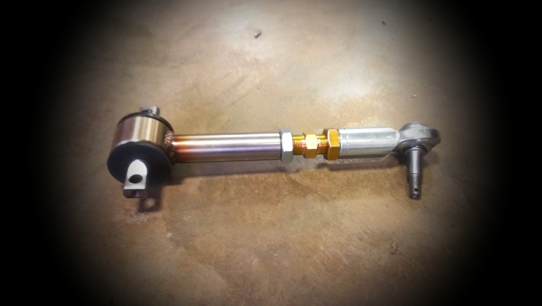

    The thing with making car parts is this, there are lots of competition, even big name companies like Moog. It's (building parts) being able to out perform the rest while still being affordable and offering features that others do not have. Lets have a look at my arm, the bushings are replaceable from Energy Suspensions. The ball joint (rod end) can be purchased whenever they start to wear out which is much cheaper than the whole arm from Moog or OEM. The part is adjustable much further than the Moog arms and can be adjusted up to -6 degrees for a slammed look. I also offer the arms in a -3 +3 length as well. These are made from stainless, not made in china, they are quality parts, and are what I consider Race Standards. Have a look at these photos of the prototype, it's on its way to Robert for testing.

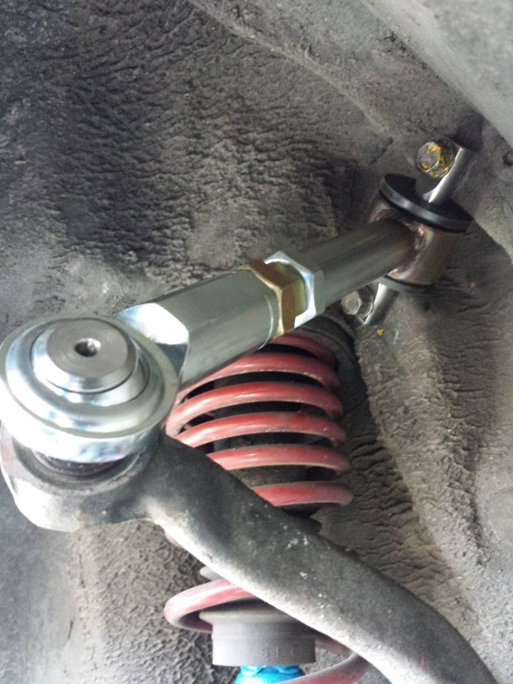

    Here are some good photos of the piece installed and adjusted to max Camber. Thanks for looking. The pin design is going to get slight revision, nothing extreme. Overall the install went very smoothly and very easy. Adjustment is easy to dial in.
    Thank you for the recommendation for the seals Lostforawhile. The Rod End you see in these photos is merely for prototyping, so it was a less expensive nickle plated part, where as the ones for sale are Nylon Race and Stainless. They seal up quite a bit better than the steel ones, less likely to make noise as well. If you have any more questions, feel free to ask.
