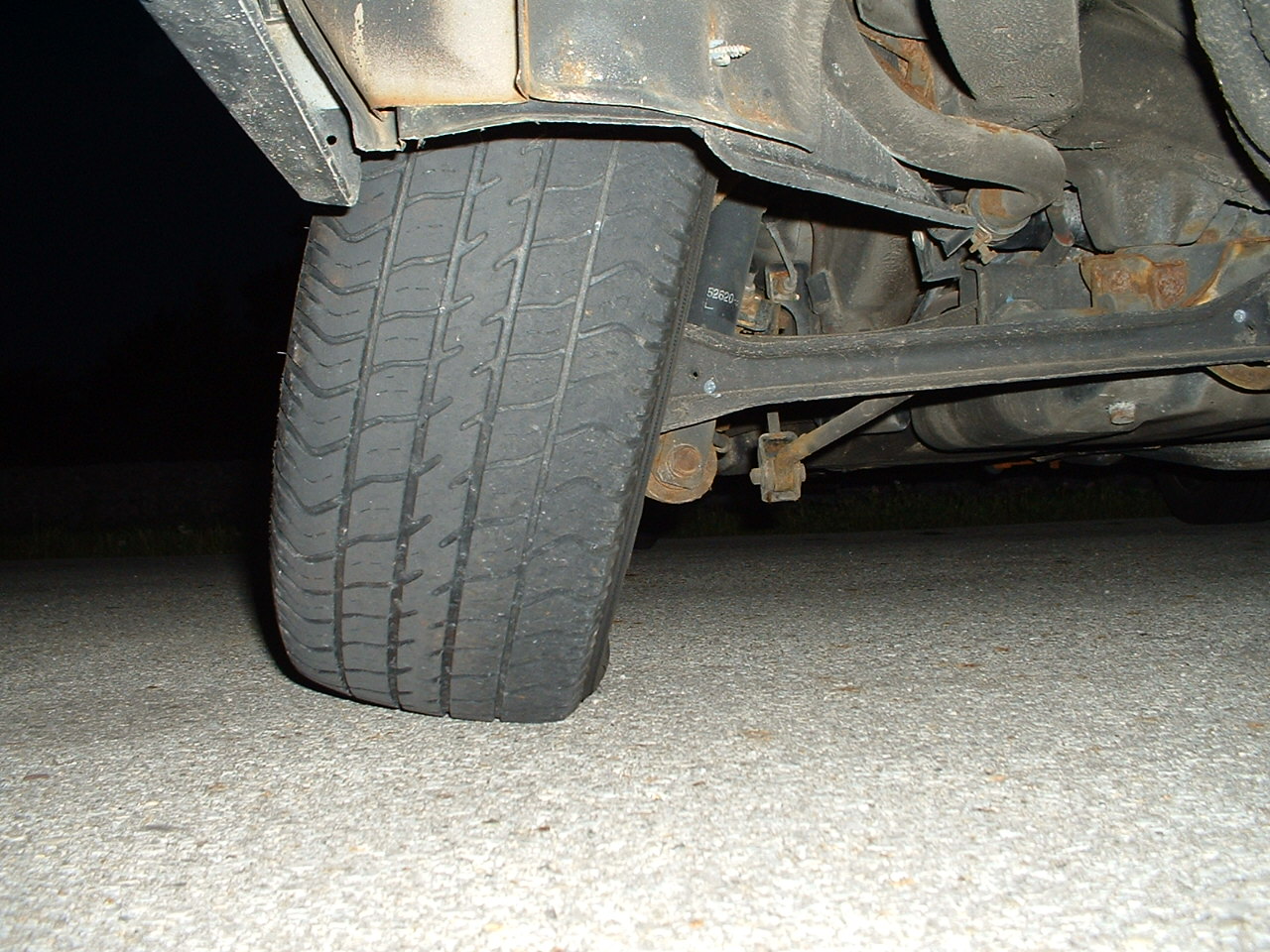

    On my '88 LX-i, the upper arm and knuckle pulled apart at the joint yesterday as I was leaving a parking lot. I immediately recognized I could not drive the car because the wheel was tilted and rubbing against the coil spring.
    The attached photo shows the separated joint. I wonder whether replacement of a bushing will fix this. The arm seems okay otherwise.
    The car is sitting near a repair shop; I had it towed there yesterday. Tomorrow morning, I'll talk to the shop owner about this, but am interested in opinions here.

    new control arm is the only option. trying to repair that would be risking your own life and others
