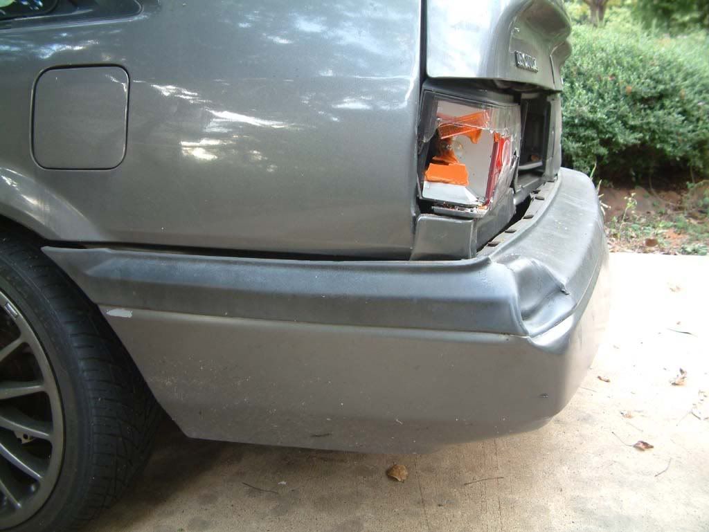

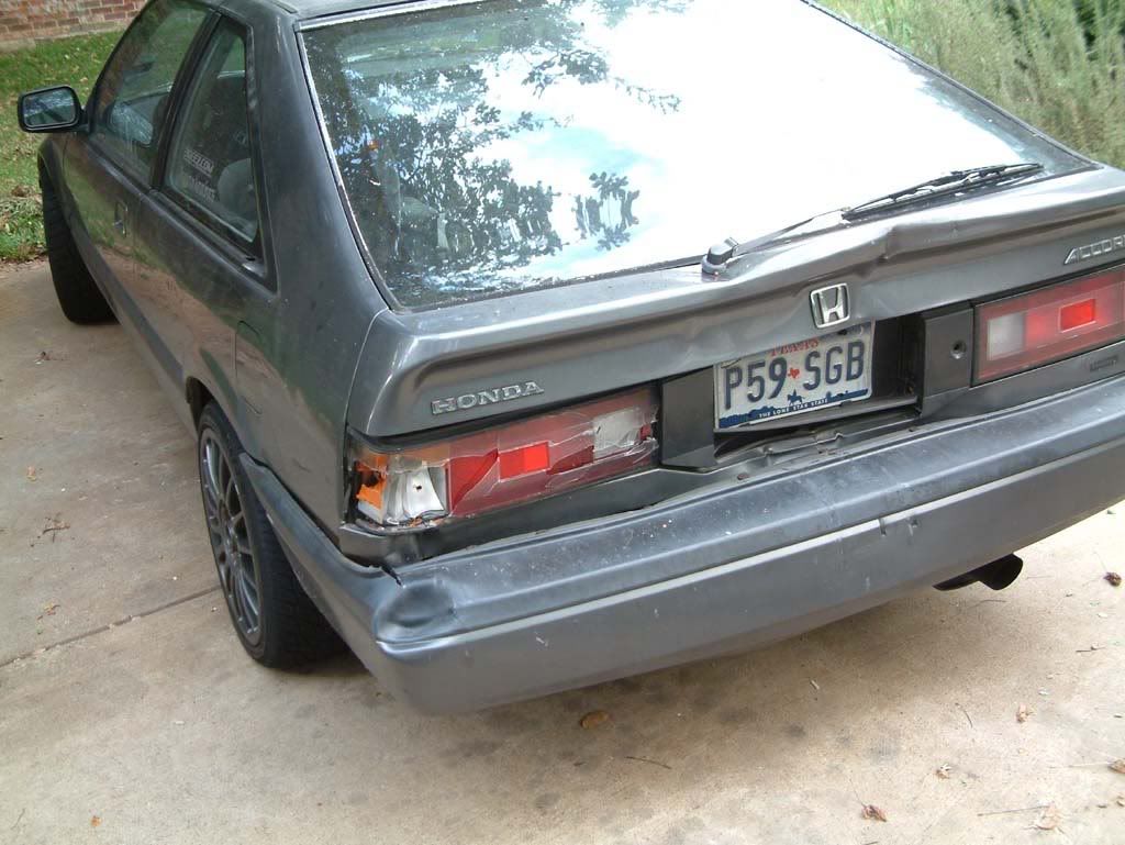

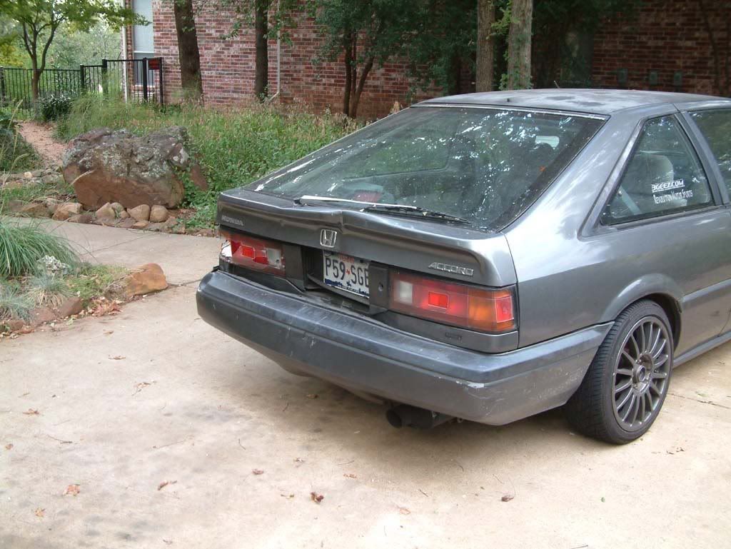

    Well you can't tell how bad the damage is until you see how far the body is caved in.
    legend,thats not that bad,mine was hit just like that when i got it and i was able to straighten it out,the body is straight too,i put it on the rack and checked. I had to replace the metal trim,the taillight,then i had to straighten out that corner,and beat the hatch floor down. also straightened out that corner with hammer and dolly work. by old rear bumper was hit in the exact same spot,just like that. the back of the body is easy to fix,everything is flat. the lights stick out beyond the body,also the trim,everything is bolted to a flat surface. i'm looking at your gas door,it's not distorted,the bumper loooks like the body is pushed in,because the metal bumper is designed to collapse in a wreck,to absorb energy. you'll need to replace the metal bumper.
    You can't see it but the c pillar is bent as well. I'm just going to find another hatch and transfer it all over. I have no body working skills at all, or time. Also here is a link to my new DD

    Yeah, I think it could be fixed, but it makes more sense to just find a new body
    well if you lived on this side of the country i would straighten that out. but if you transfer at least it's still a hatchie. hey when your ready to transfer,i might buy that right light from you, and the unbent half of the metal trim. they always rust on the right side, so i need a ready made patch panel.

    that sucks, but for a 50mph crash, i would of expected the whole ass of the car to be shoved in
