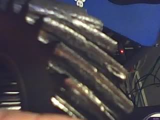

    Got the other gears in there. Didn't even have to take the tire off. That easy. I'll post some pics of the whiny gears later tonight. Those things were kinda ugly.

    Here it is. The gears were crazy chewed up, picture doesn't really do it justice. The whole process was incredibly easy though...with my impact gun.
