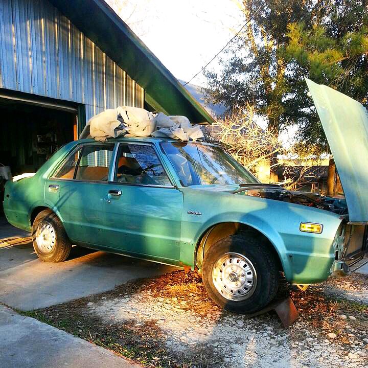

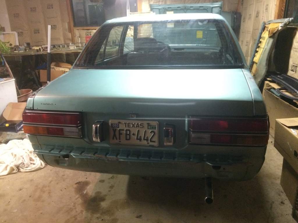

Thanks! It's original, has the same tires from 81, plates from 81, Honda oil filter (I changed it). The car was wrecked when new and never fixed.

Damn thats a clean car man. Looks bitchin. What exactly is wrong with it?

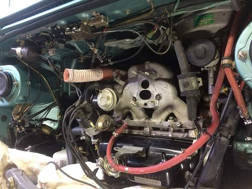

Need more pics then!! Judging by how shiny the engine parts are I wouldn't doubt the 8k miles now!

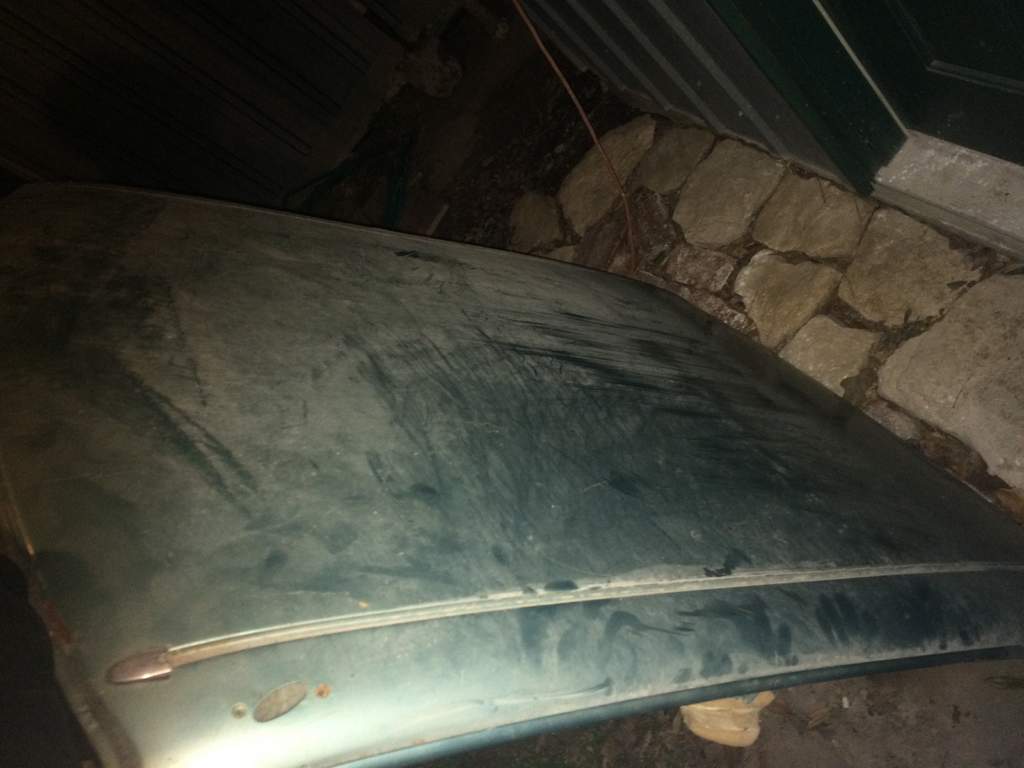

It was put into a ditch on a dirt road is what I've been told. The front clip (fenders and hold) are off the donor car. The roof is wrinkled, but there is a replacement off the donor car. Mechanicaly it has just been sitting. Cleaned the gas tank and cleared the hydraulic lines. It has a few other dents on the quarters and one by the mirror that I have already hammer/dollied out. I'm using it to practice body work, which has gone good so far. The only problem I'm at now is the fuel pump is not turning on. But I have other threads for that.
Re: New 1g accord owner
That roof seems like a bitch to fix. You gonna weld in another roof skin to fix that?

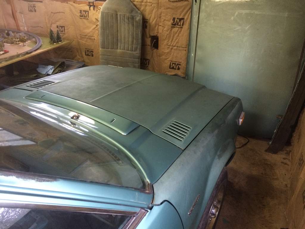

I'm going to try to cut the whole thing off at the pillars. Seems like the easiest way to do it, as long as I can keep everything lined up correctly
That roof looks bad. Have you checked for frame damage at all? It would suck to spend a bunch of time and money getting it back on the road, only to find out it has a high speed shimmy or screwy tire wear or some other kind of issue that involves putting it on a frame rack. Glad you're keeping it out of the wrecking yard though.

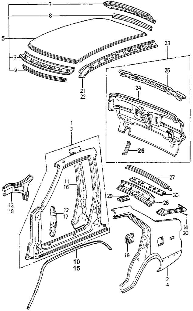

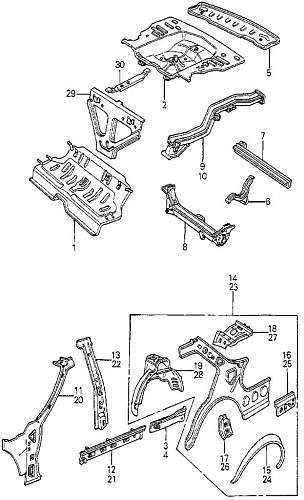

Useful for reference perhaps. (Though obviously body side outer was one piece for production instead of two)
1981 Honda Accord 4 Door SE KL 5MT Body Structure Components
Attachment 6859Attachment 6860
Or I guess you could get an appropriate sized sunroof from a wrecker & not be too guilty if there's some filler remaining in the roof.

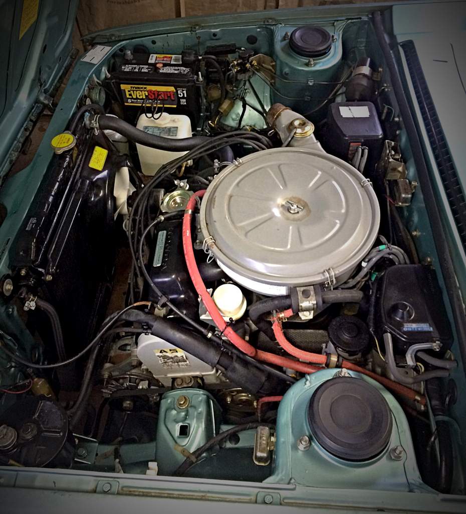

Replaced the fuel pump, found the correct fuel relay (needed to be bypassed) and had to clear out the in tank pickup. Also had to replace the rubber fuel lines. But she started right up, and sounded oh so smooth.

The car only runs for ten seconds, and only after sitting for a few minutes. I rebuilt the carb and have the same problem. Fuel is now leaking from the middle (secondary?) barrel. Does anybody have experience on these carbs?
