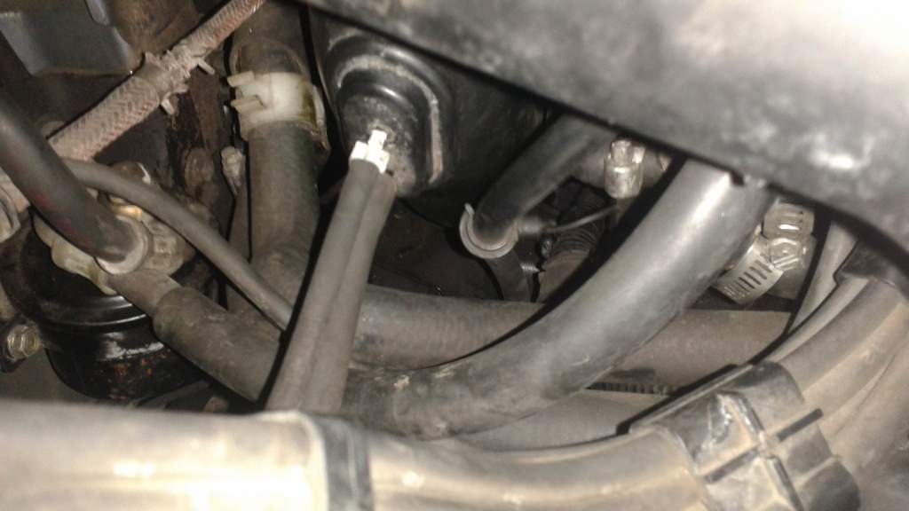

Oh yes, very familiar with that hose, I had a go round with that once before.
This hose was leaking so I had to put a new one in. It connects to the main coolant pipe across the back of the engine to a fitting on the intake manifold right by the PCV valve.Attachment 9530

The hose connects to the underside of the intake manifold. It's "piped" at that spot to make it to the topside of the manifold right between the throttle body and the valve cover.

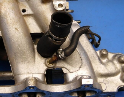

Someone may have to clarify for me but as far as I remember, there are no water lines at all that go through the intake manifold on the FI models other than the IACV lines. The carb ones do have water lines that go through the intake but I'm pretty sure the FI do not.
If I'm thinking of what you're describing, that is the PCV line.
Re: 1986 LXi miss on 1 & 4
https://www.ebay.com/itm/86-87-Accor...-/192716986383
Sorry for it being an ebay link, but about the only picture I could find. go to the pic of the manifold bottom, that small hose connected to a metal fitting right next to the large hose, is that the one you're talking about?

Yup, that's the one. It looks real innocent there, but trying to get to it is a real chore.
If I was to get into the heads of the design team for Honda I think this was their way to pass this line from the bottom of the manifold to the top without risk of cooking a rubber hose on the manifold (their is another coolant fitting directly above it right next to the PCV valve.)
