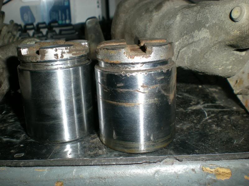

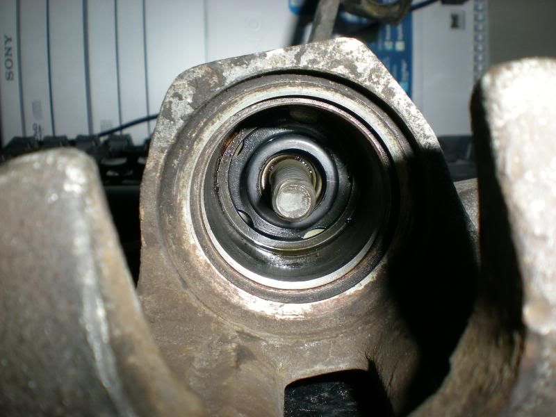

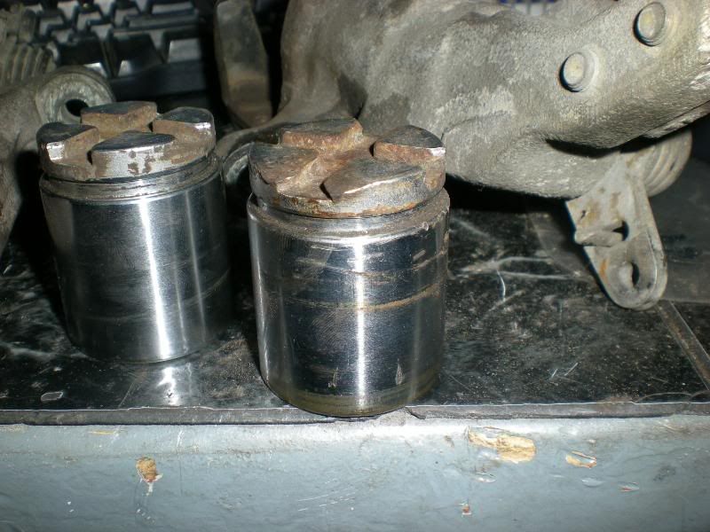

its tough to tell from the pictures...but some of the gouges look deep...
What if you take a fine scotch brite pad of steel wool and try and clean it up a bit?
Re: Rebuild or Buy new ones?
yeah they're kinda deep not surface scratches...looks like someone was putting pressure with a flat object and slipped a few times

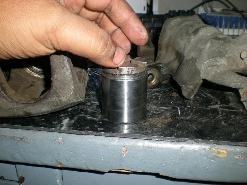

If the caliper itself is fine and only the piston is the issue, just order a new piston. It would probably be cheaper to get a new piston rather than a whole new caliper.
where do i order pistons from?

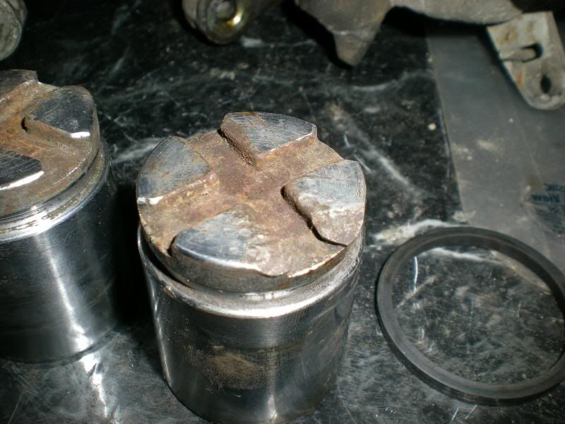

Been a while since I rebuilt calipers. Shop I first mechanic'ed at we rebuilt them all the time. Right piston is shot . The rust ridge and knicks will let fluid thru. As long as the bores are ok a standard size pistons would prolly make it.

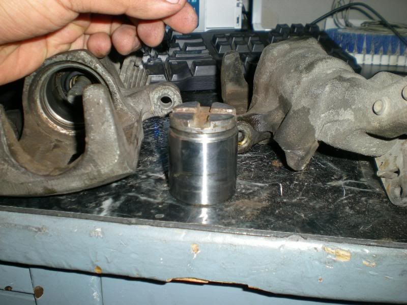

Only problem is that the piston is threaded in, so he would need to find a piston that threads in.
yeah the piston has threads and twists on. i think im just going to say fuck it and buy new ones...gay.

Most of the Honda's rear brakes are like that.See if one of the other gens have the same bore size. Most of the front do from what I have seen. Rockauto seems to list rebuild kits. I would try NAPA as well.

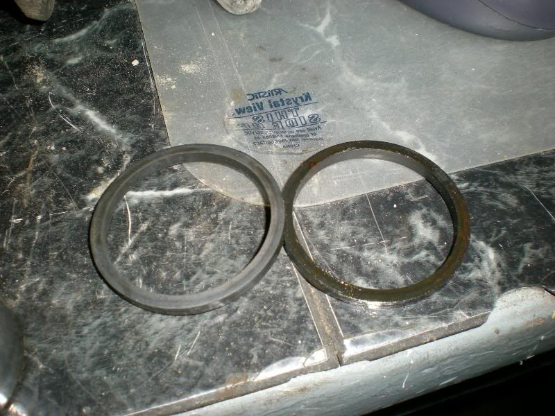

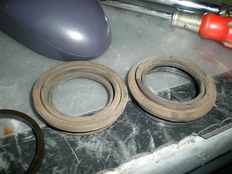

I mean you could get new seal ,clean off the rust ridge, and try it. Its just a rear brake.

thats what i was thinking...they ARE just rear brakes. and when i was putting air into the piston to pop it out...no excess fluid came out through the boot. so that makes em think that they would work just fine. but the top of the piston worries me. for some reason i think that the pads would wear unevenly and maybe fuck up my rotors. and they're powerslot rotors...so i dont want that to happen lol. ill keep you guys updated
if the bores in the calipers are good, just do pistons and seals.
dont forget to clean the slide pins and grease the with an anti seize compound like copper slip or similar.
they may only do 30% of th work but its sumthing you gotta do for your own safety.
i dont like the looks of the pistons you have so i'd be replacing them myself.
do the both sides at once and when you can aford do the fronts as well.
