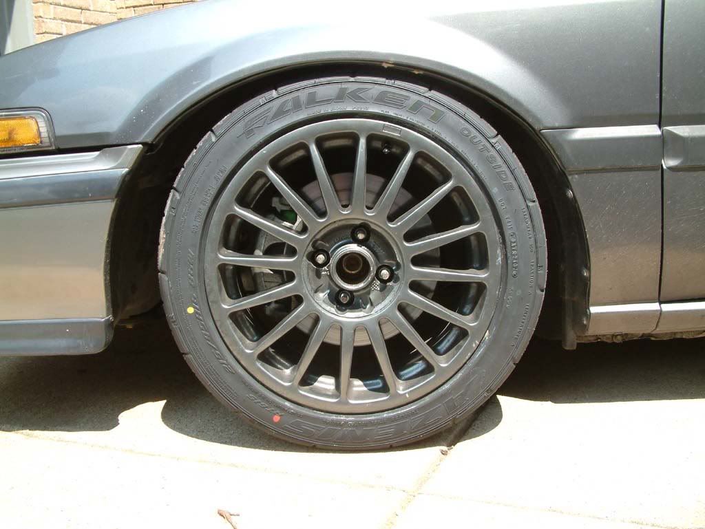

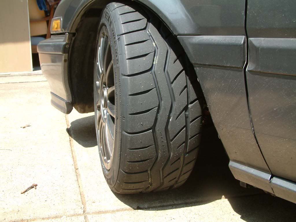

These are not designed to completely slam the car, but you can go pretty low. If you roll the fender lip, you should be able to fit some pretty fat tires under there. I had 215/50/r16s they never rubbed except just a slight bit on the inner wheel well if I hit a bump will making a u-turn.
Re: School me on lowering
And you had these coilovers with that tire size? Got any pics by chance?
What was the lowest you went with these coilovers?
Sent from my SPH-L900 using Tapatalk 2
Originally Posted by
Clockworkz
I had d2s, you can find my thread about those in the how to section. They are just re-branded k-sport coil overs. With extended top hats I'm sure your could go lower.
On my 1988
http://img.photobucket.com/albums/v6...d/DSCF0070.jpg
On my 1986
http://img.photobucket.com/albums/v6...SCF0019net.jpg
http://img.photobucket.com/albums/v6...SCF0018net.jpg
http://img.photobucket.com/albums/v6...SCF0021net.jpg
Tires in the rear are lower profile, like 205/45/r16
