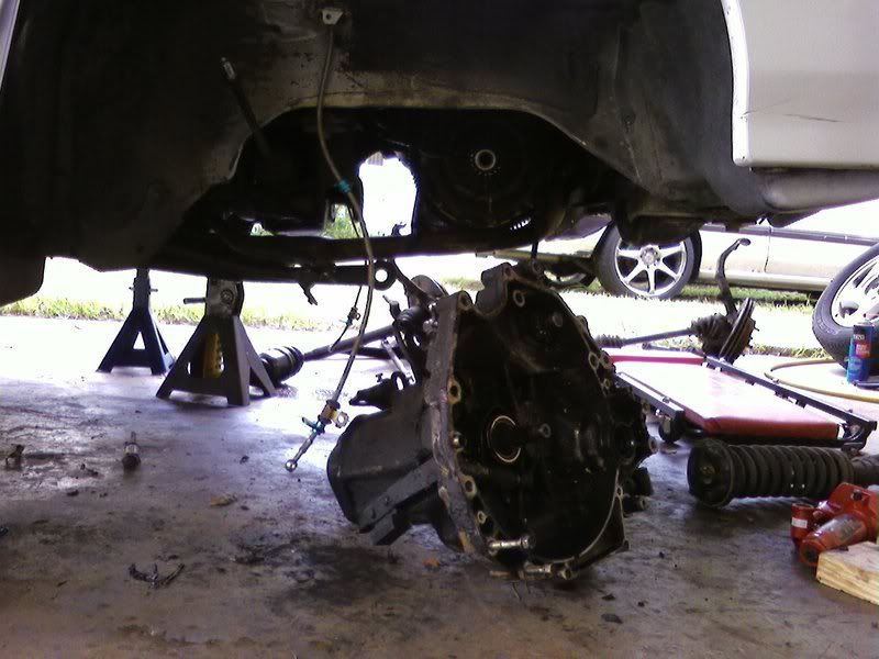

Re: Labeledsk8r's 89 LX-i coupe update thread
http://i4.photobucket.com/albums/y12...rk28-28-08.jpg
quick pic before i leave for work.. i will update later
Good to see. Now you are over the half way point.
Well after this there won't be anything you can't tackle,

just got off work so i will update.. i didnt have enough time to take the clutch or presure plate off.. the trans itself looks fine the spring is fine everytihng in the bellhouseing looks fine just super greasy.. i will get up early tomarrow and inspect it all before i go to work again, also how do i check to see if the throwout bearing is bad? another thing i just had this clutch installed but its allready coated in black buildup is this normal
You need to check for freeplay in the bearing. It shouldn't have any play, if it has play replace it along with the spring. As far as black buildup, I didn't have any type of buildup when I pulled my trans off after I replaced the clutch a year ago. I had some dust from the clutch but it still looked clean. Mark the pressure plate and flywheel with whiteout so you can reinstall it correctly later. It may not make a difference but its a good piece of mind.
