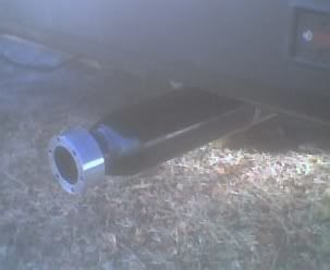

ok i made the best of it and made it look good,the muffler wouldn't hang right and by switching one of the donuts it finally literally fell into place. I also made a new billet tip since the other one wouldn't work any more. here are some pics.

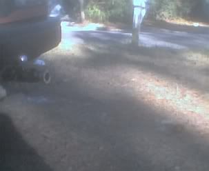

ok finished and on the car

I wanted to note believe it or not this thing is quiet now,you think glass pack,but i don't know if the longer glass pack is better and canceling sound waves or what.but it is quiet. the other one was deafening,and with it off the car it sounded like ,what do you call them,those instruments you shake? the packing had completly burned up and was rattling around loose in the old one. :lol:

Man Tim that is absolutely AWESOME!!! Do you own a lathe? Or is that even what you were using to make the tip? I am looking at getting a glass pack as well but, I don't really like the quite sound but, I also don't like the ricer coffee can sound either. So, I'm kinda confused as to what to buy if you got the thrush glass pack and it's quiet then I know that that's not what I want. Oh well I guess just kinda trial and error except I don't have the money to try and then find out it doesn't work. I'll ask a friend of mine what bullet casing equates to 1/4" and see what I can do. Good Work!

I made that at work i wish i did have my own lathe. I guess the noise level of the muffler is really a matter of perspective, i mean it's a lot louder then a stock muffler,but it's not really ricy to me, remember i just replaced a blown out glass pack,so it's all quieter to me. this one on here now is a real cherry bomb, i just repainted it was all. Mine is a little louder because i have a complete different system and no converter. I guess ricy sounding is different to different people.Quote:

I finally got the stupid muffler to hang right under the bumper, i had to modify the bracket assembly to push down on the muffler,against the tension of the hangers further forward,this was so it didn't touch the bottom of the bumper. I ended up with an articulated aluminum assembly that looks like something that would hang the muffler on a formula car.
