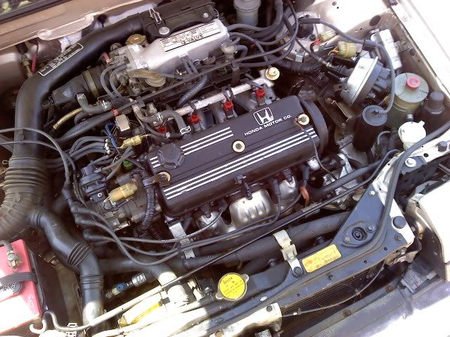

It had been sounding like a subaru, kind of a skip but not really ya know?
Also it was pinging at highway speed with no load and I knew that couldnt be good either. Mileage was lousy, around 20.. power was all at the bottom, just off idle then poof it really wasnt torquey at all.
So, I pulled the cam cover off and loosened the bracket that holds the AC hose bracket so that I could see a clear view of the flywheel marks.
I removed all the spark plugs (new) so there would be no compression and I could turn the motor over easy by hand. Sure enough, the cam timing marks were lined up with the wrong marks on the flywheel. Someone had it timed up to the red mark. There are so many marks on the flywheel, it is easy to get confused. EVen some books do not reference the correct mark to set the valve timing with.
I used the "T" mark which is near by the green dot. I loosened up the tensioner, which can be done outside of the cover without removing anything. Then slid off the T belt very carefully and turned the cam gear one knotch... slid it back on. Lucky for me this went without a hitch this time. Then I turned the motor over via a rachet and 17mm socket thru the wheel well, about 1.5 revolutions then tightened up the tensioner bolt (12mm)
Wow what a difference, nice bit of power now and no "almost" misfire sounds...

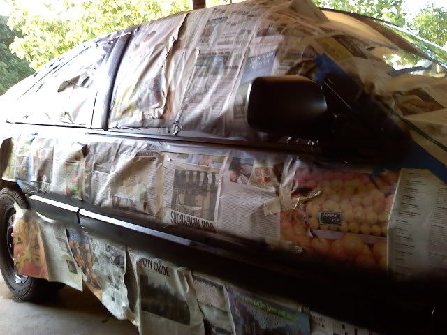

Ok I got half the mouldings reblacked this afternoon, I will do the front and drivers side in a few days. The plastic coating was peeling off the window threshold mouldings so I peeled it all off and wet sanded with 320 then 800. I recaulked behind those so water wont get in there under the moulding. I had to remove the pop out window which was very easy but one of the hinge fasterner seemed to break. It is not holding well so I will have to take the window out again to see how I can tighten that up. I used Wurth semi gloss black moulding paint automotive, which is great stuff.
I will post a better final product pic when I get more light, it got dark on me after I was done!

Looking good, more details on the paint, my moldings are up in my garage loft.It's odd how you can have a car all apart yet still know where everything is.

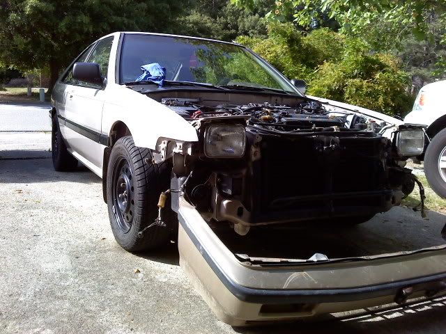

Im going to JY today and see if there is an LXI sedan front bumpe cover and hood in beige, and large console armrest. The plastic clip nut thing that the screw goes in for the hatch side window broke, lower one. Should be easy enough to make something else work there so the window wont sag.

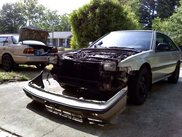

I picked up a 88-89 bumper, it will not tighten up for some reason, I was tired by the time I got to that so I will figiure it out. Bolts tight, even snapped one off ughhh..
Since Im going with black side moulding, the later style bumper completes the line around the car where as the early style really doesnt IMO. I will finally use the clear corners I got that go well with clear lense ts yay.
