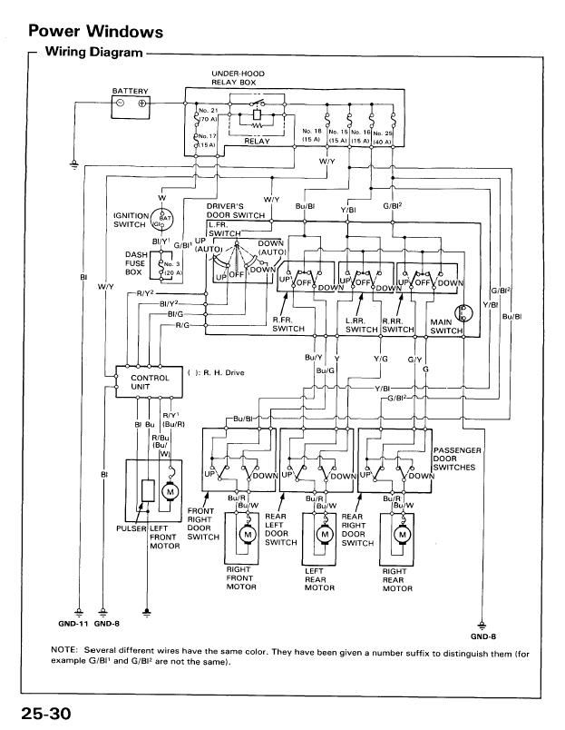

    If you have the downloaded shop manual it has the wiring diagram for the windows (page 25-30), to help you pin point your problem.

    were do i download the manual? is it the one on pauls site?
    zach
    Re: Its Been Two Years And I Still Cant Get My Windows To Work!!
    just browsing thru pauls shop manual, i <3 that so much, i think this is a diagram:

    Multimeter & wire taps are your best friend with that wiring diagram.
