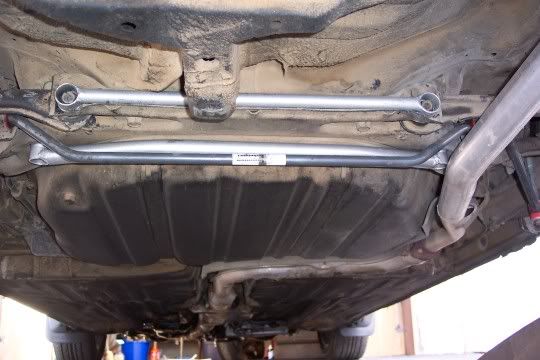

    Yeah there is a small knotch/bump somewhere in the back of the car that I've used to jack up the rear before... or they say get a long 2x4 and use that to spread the weight out over the rear.

    u got like a pic of this knotch??
    dont worry mate, that'll buff right out
    Re: Jacking Rear of Car
    see the hump now?
    ahhh yep
