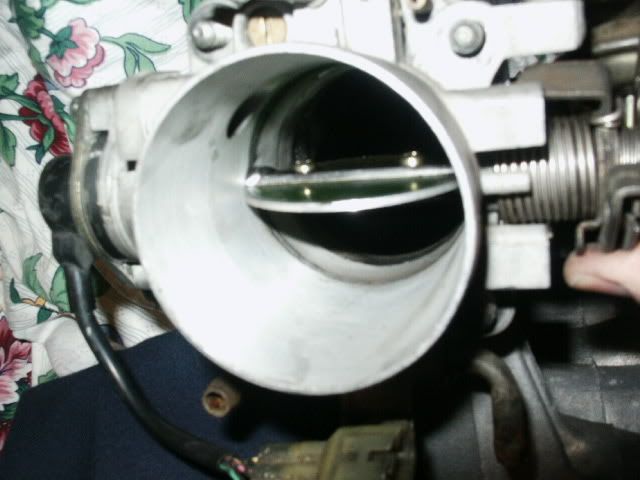

    These are of the two parts of the kit that I sold. It was for 86-87 though, I only had the T/B and intake manni. You guy missed out on it, could have gotten it SUPER cheap from me.

    I have those now. They are probably the best mod I've done to date.
