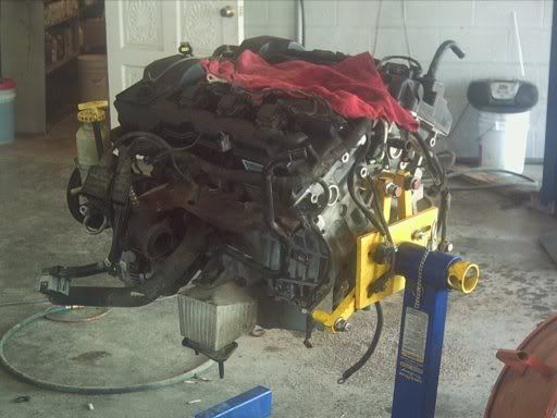

    Yep, the oil sludge buildup in the motor causes engine failure. I'm currently rebuilding two 2.7 liter engines, & had nothing but headaches with them. I wish I had pics of the inside of one of the engines.
    Anyhow, the engine in the first & second pic had engine slugde so bad, it was cooked on about 1/4 inch, burned up the piston rings & had no compression.
    The last pic had exhaust valves bent flat cause of timing chain guide breaking. This motor is Interference design. Here is link I been looking at too.
