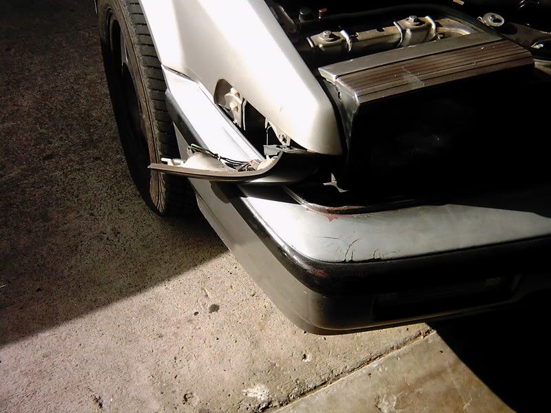

    turn you lights on/raise headlight buckets, and look on the inside corner of the turn signal and you will see to vertical holes and those hole remove your turn signals with a phillips. be careful though they are probally really brittle and make sure you pull them foward b/c i pulled them off sideways and broke the plastic clips that hold them in place

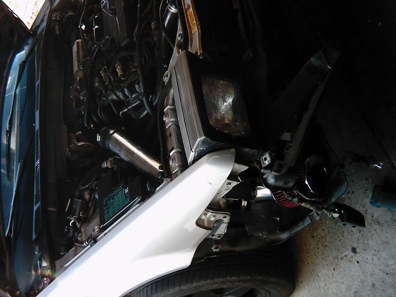

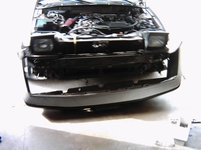

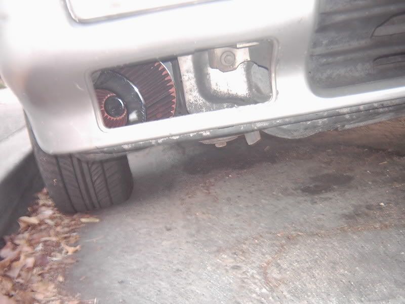

    alright here we go random pics

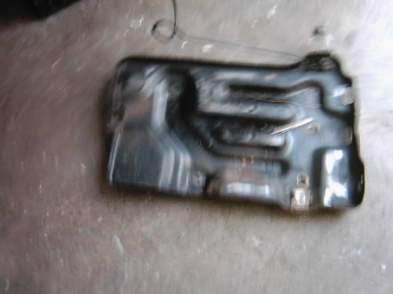

    i took of my battery tray to modify it so the battery could be crooked but got lazy and didnt even use it (dont ask how my battery is bein held down haha)

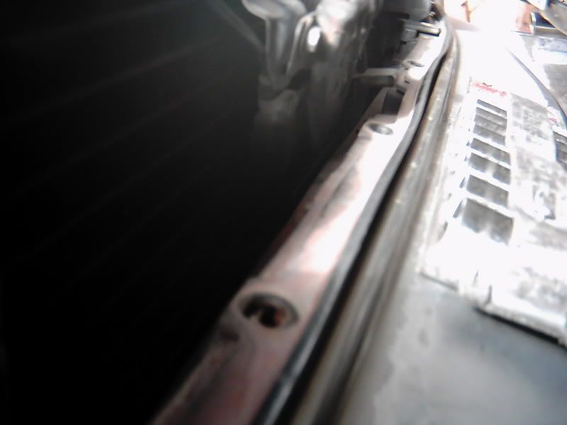

    these are the top bolts of the bumper (?)
    THANKS!!

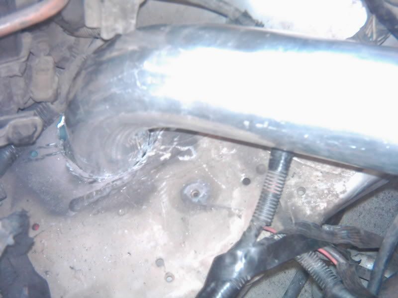

    i was using a small ass dremel thing but it sucked, so i ended up just bending it with a hammer, it looks shitty but i dont care
    here it is done
    the end'
    thanks for everyones help, it looks ghetto but i dont care haha,and yea i know this camera sucks i dont know why i didnt use my kodak one

    Quote Originally Posted by 895spdforfree
    lol this is the funniest line ever. but yeah that camera is pretty bad but the install looks good. great job!
