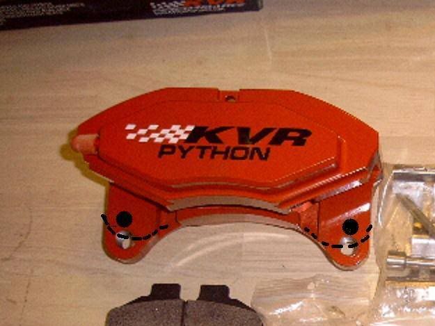

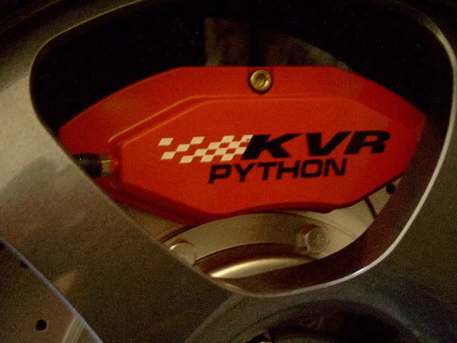

    I recently swapped in some new calipers on the hatch. I got a good deal on the KVR performance 4 piston calipers and could not resist so like always I had to "MODIFY" them to fit on the caliper relocation bracket to fit over the AEM rotors. I havent driven the car yet beacuse my "great" optima battery took a crap and since I dont have the receipt nymore I have to wait for them to ship me a new one.
    Anyway since Steve inquired as to what I was doing here you go a couple of pics of the new setup.

    What did you do to get those to fit and how would they fit a stock rotor?

    they would not fit the stock rotor but....... they will fit 11" rotors so in theory you get some 11" rotors with a 4x100 bolt pattern and you could bolt them up to the accord

    yes they do. They are the correct bolt spacing and thread pitch. but then again youd have to upgrade to 11"rotors which I think Legendmaster said he got some for like an 02 civic or so. Backspacing might be an issue but could probably easily be solved with spacers.

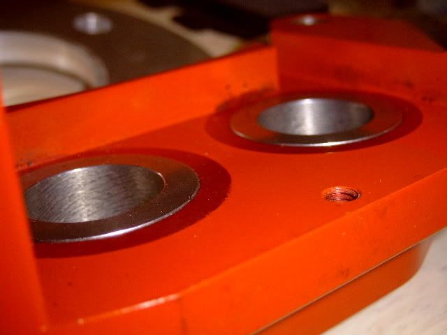

    Now if you wanted them to fit your stock rotor youd probably have to do something like this
    Which is what i had to do to get them to fit correctly on the bracket for the 12 inch aem rotors. if I wouldnt have modified the caliper I would have had to upgrade to 13 inch rotors and those are just overkill, not to mention expensive for some good ones.

    go herehttp://kvrperformance.com/store/adva...=hc532&x=5&y=5
    you can see which ones they bolt straight up to because it only costs 695 for the calipers as oposed to 1595 for the calipers, brackets. 13" rotors.
    there might be other part numbers that will bolt straight up to the accord rotor no problem but you'd probably hve to call and ask.

    damn Dennis...good job on the clean instalation....and homie sabz...sticky this biznatch

    killer upgrade. so how does it perform / anything you have to tweak on the brakes. Good job bro.
