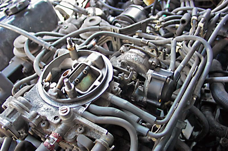

    im going to take a pic of my carb and choke then clean the window and check my float level after i finish watching ghost rider. So stayed tuned

    Heres pics of my carb with the engine off, when the car warmed up the choke was open.
    Tell me whats wrong.

    Is that with the engine cold? If so, the choke is supposed to be closed further. If you don't push the pedal in once before starting, the choke will remain open. So do that when it's cold, it should be almost (if not) completely closed.
