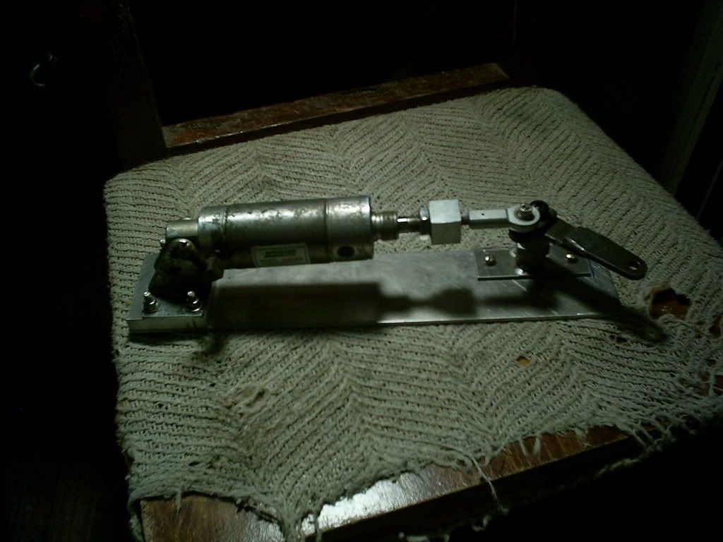

    got some of the mechanicals done today, the cyl mounts under the drivers seat longways, and i made a lever assembly that increases the length of the stroke and changes it's direction.
    the lever will operate a pushrod that slides the cup holder in and out of it's case. the cupholder will mount to the beam right under the front edge of the drivers seat, and will slide in or out with a switch.

    all right everything fits nicely behind the computer under the drivers seat.even with the seat all the way forward,you can just see the edge of it. i will have to make the mounting plate for the cup holder itself, i can't figure a way to directly attach screws into it,so i'll bond a 1/8 aluminum plate to the bottom of it,with epoxy. then the plate will attach with machine screws. once i get these two pieces mounted painted,and everything else, then i can add the linkages. and hook up the vaccume valves to the switch. then it will be done.

    i'm not too lazy to open it,just an interesting way to do it. and the cupholder will slide out from under the seat,it's attached to the beam under the drivers seat so your drinks are right at the front edge of the seat. it doesn't get in the way at all i tried it i'm putting a different kind of holder on my wifes side. this is like james bond stuff

    naa it's telling me it was a shitty weld,the mechanism other then that works flawlessly. needs 3.5 inches of travel to open the holder all the way,i've got exactly that amount. should work with no problem.
