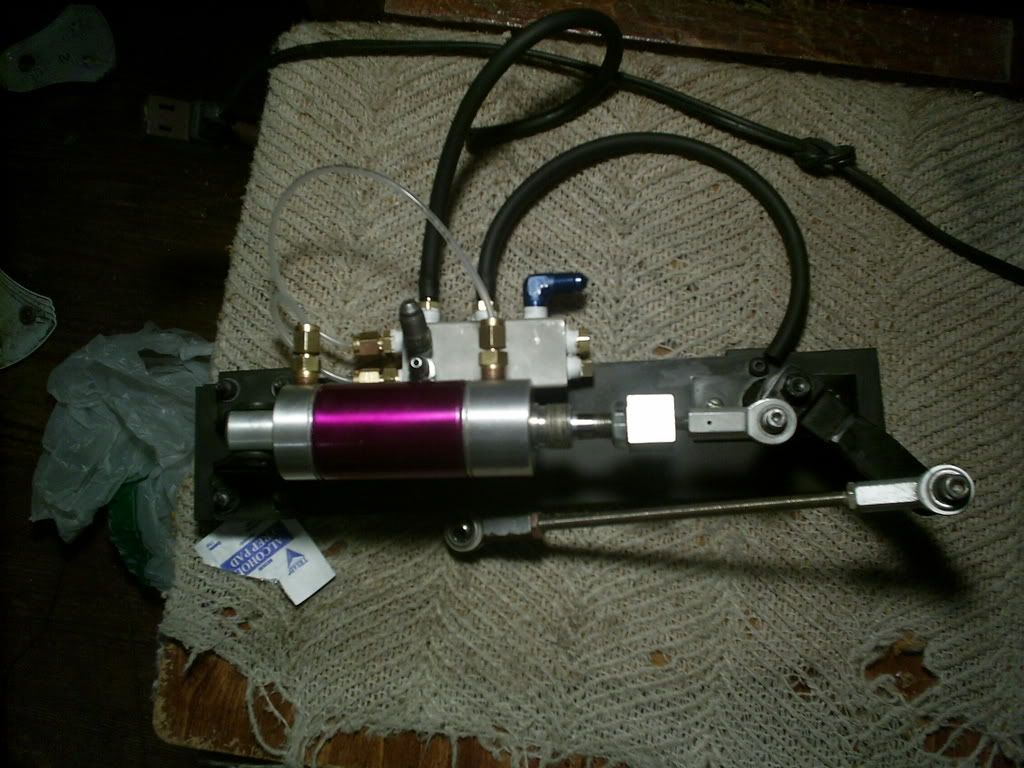

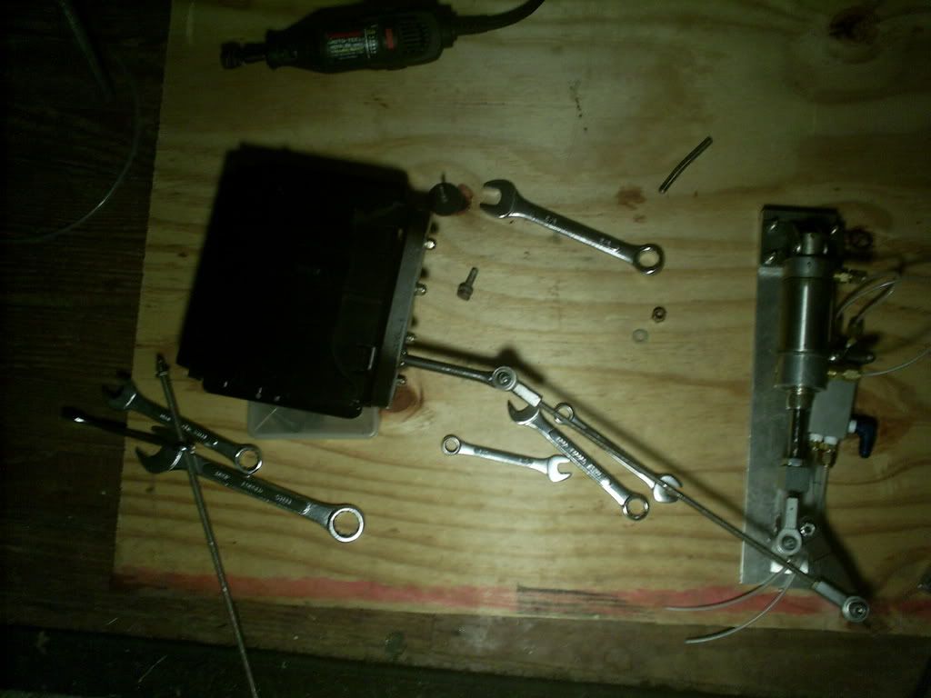

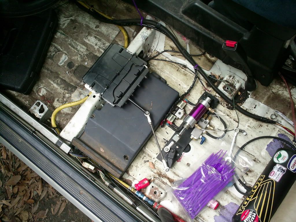

    ok more progress i had it hooked up on a piece of wood to check to make sure all the linkages work properly. the pushrod will be much shorter on the car of course.

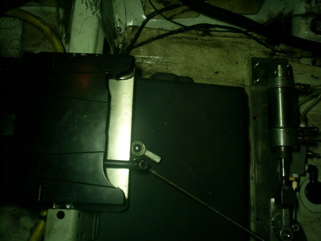

    sorry about the nasty floor carpet is coming soon,it's tax refund time.

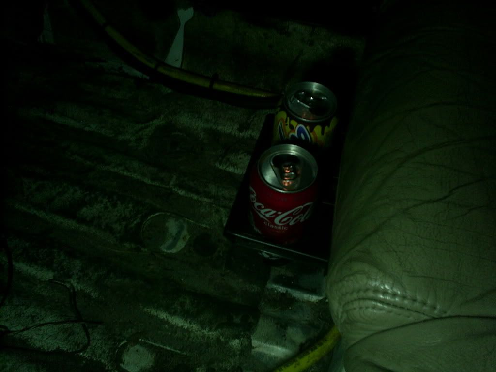

    test fit,and the holder disappears under the seat.
    [floor looks like crap because of dirt will look so much nicer with fresh black carpet.

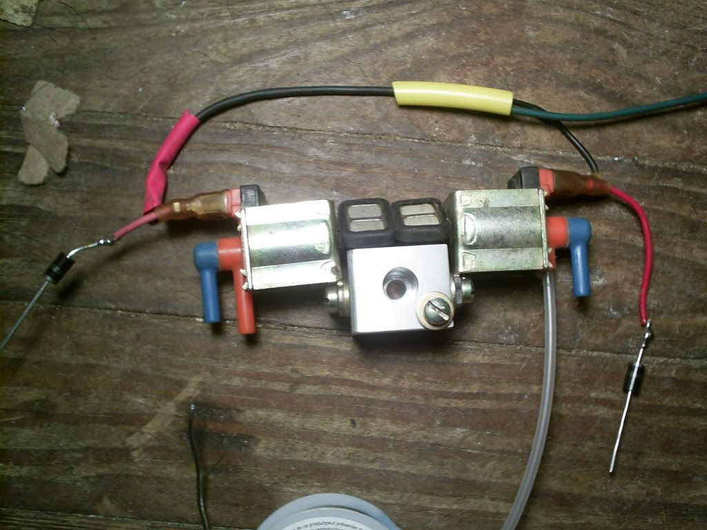

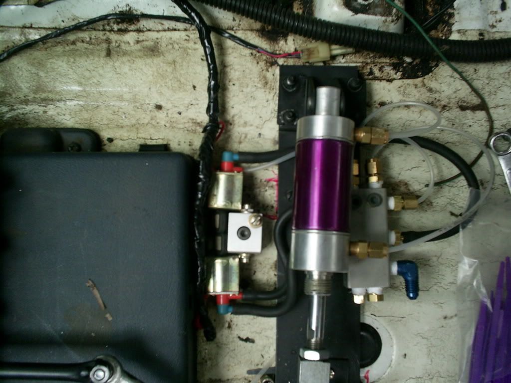

    more done, the valve body assembly. i used reverse bias diodes, then i only need two wires to control both valves. i'm using a power antenna switch, when the current is going one direction,one valve operates,when it goes the other direction,the other valve operates. these are a couple of valves out of an old black box,they are self venting. when you turn off power to the valve, the controlled side of the valve vents it's vaccume.

    i'm finishing the wiring and hooking up the plumbing right now

    here ya go. in the first part of the video i didn't have the car on so i was almost out of stored vaccume. works great though.
