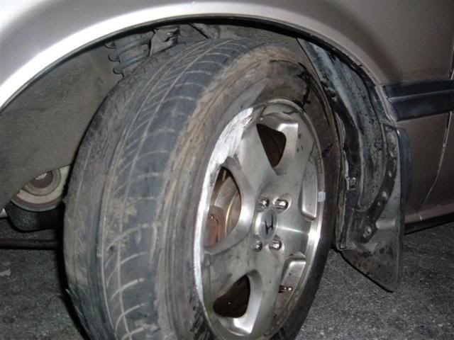

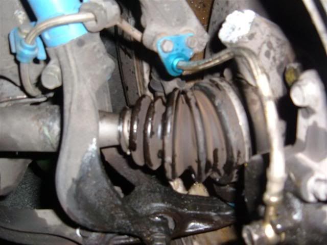

    well...i understamated the turn...and went on the curb at like 45mph...jumped up the side...broke the tie rod, upper arm....and no i was not racing or drifting.....just a late reaction from me...no more fat fives...lower control arm is fucked....and my door wont open...so the fender is fucked also. il guess il tow it to my uncles and we will have to work on it.

    what the hell man, the whole knuckle snapped, you smacked the shit outta something, and what is the deal with that tire all skinned off, have you been driving with that tire like that? No wonder it wouldn't turn !!!!

    Is there actually tread on that tire, or is that some chalk lines you drew on it?
    FWD+bald tire+late reaction=curb kiss. The good news is you could have been into the other lane and into traffic instead.

    Ouch. Good time to replace the rack and pinion now...

    well ima go borrow a jack so i can put it on jack stands and hope for the worse.... the rim is bent beyond use..its just part of the lip missing. and yup tweaked everything.

    I would replace everything from the axle out, just go to the JY Hopefully the strut tower isnt bent, but is sounds like it may be if you cant openthe door.

    Nooo ! Hopefully your strut tower isn't bent. If its not the fix shouldn't be too bad. Good luck with the repairs man.
