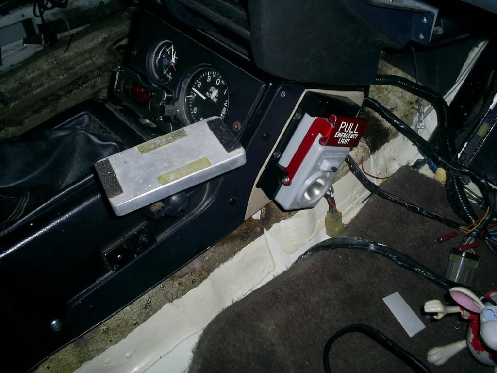

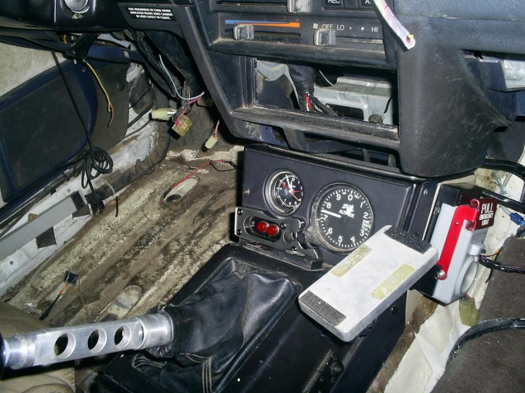

I got the bracket built for the aircraft emergency light, and I test fitted everything, I've been trying to work on the car, but even after 20 minutes out there, I'm sweating to death. It's just to hot to do anything.

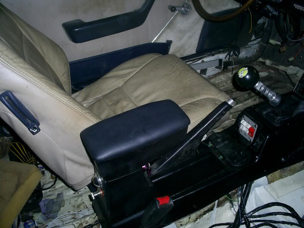

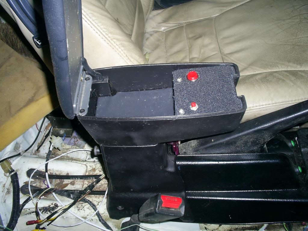

I like the work, but the whole thing is just too much for me. Since I haven't been keeping track of the other thread about this, do all of the buttons you've installed do something (or will end up doing something)?

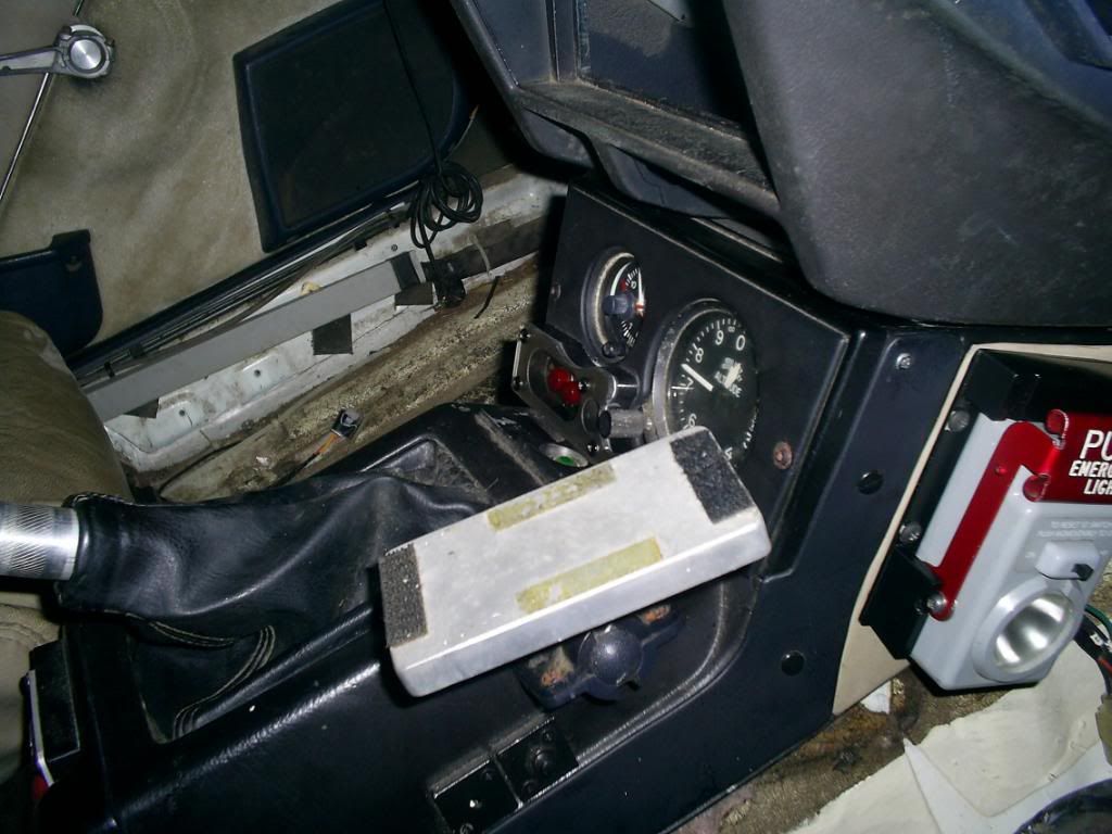

^ I'm guessing it turns on the light it's attached to.
Itzdave sent it to me, it's from an aircraft, it's an emergency flashlight, you pull the handle down and it comes off of the bracket, it would have originally charged from the airplane, but it uses two rechargeable C batteries, I just put two standard C batteries in it. also has a g force sensor in it, in a wreck it will come on on it's own. a;ways good to have a flashlight handy at night, and it's military hardware. I had to make the bracket it's attached to https://www.3geez.com/forum/showthread.php?t=73362
the big flat aluminum bracket is left over from my old Nokia analog cell phone, best phone I ever owned. it was the handset with the radio box at the back. I'm going to modify that plate with a lighter one for an Ipod cradle, you can get the harness with the plug that charges the battery, and has a left and right audio output. I have a wired FM modulator for the Ipod to run it through the radio, the mirror switch in the center console goes to a relay box and an SWI-x unit, it turns the eight possible outputs of the mirror switch into remote control signals for the radio

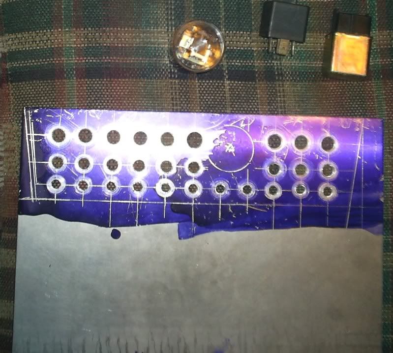

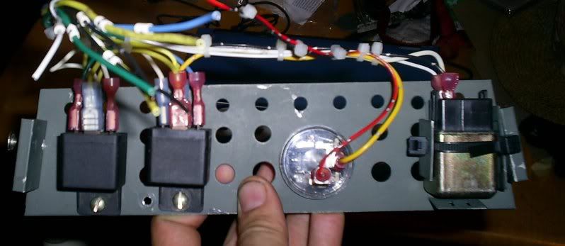

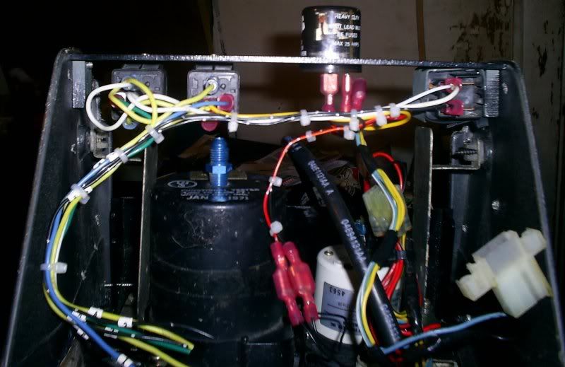

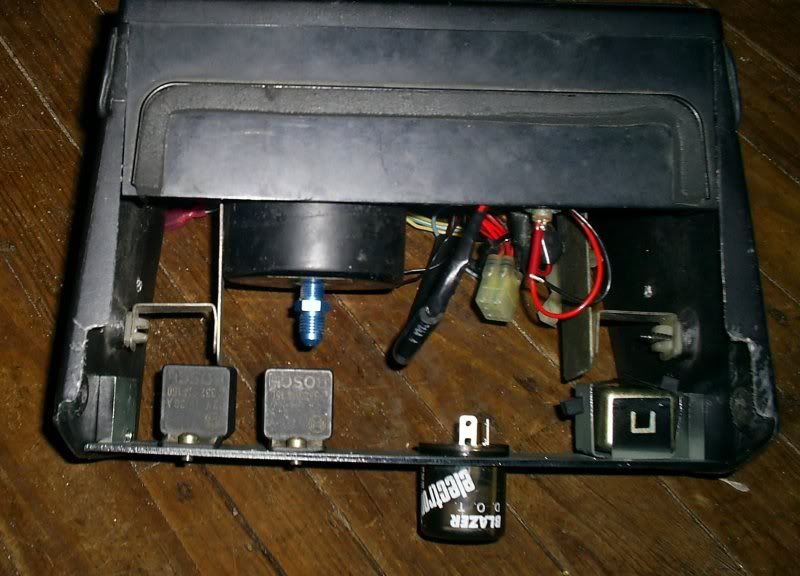

Another small piece, this is the panel that fits at the back of the console, since I don't have a shear here, I haven't sheared the angles yet. this is what the three relays for the start button attach to. they go on the inside of the panel. the round area has to milled out yet, it's for an electronic flasher, the dual red lights on the panel, are for one of the oil pressure warnings. I have the regular one, but since I have the remote oil filter and cooler, I have a secondary sensor on the return side of the filter. This tells me if i lose pressure on the return side of the filter EG clogged filter.
Here's the panel installed with the relays for the start button, very tight fit on everything, I'm trying to work on a little at a time and get parts ready to install
