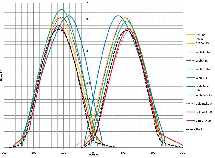

    Just wanted to add some notes here.
    Web does regrinds and weld ups depending on which grind you choose. The stage 1 and 2 are regrinds and the race cam is a weld up. Web also makes the cams for Bisi but I don't know if they are the same grinds or if Bisi spec'd them differently. Colt also does regrinds or weld ups depending on what you want.
    The Colt is a stage 1 triflow that I measured from my own head. There is still some question about the lift numbers of the Colt vs the others since the Colt is the only aftermarket cam with direct measurements. The others are based on published specs which may not match real world results exactly. I'm also going to take some more detailed measurements on the Colt and a stock cam to see if my measurement technique is adding some error.
    It would be really great if we could get some actual measurements on the Delta or Web cams.

    very instresting...No delta cam graph?
    We don't have any specs for Delta. If someone has a spare to send me I would be more than happy to measure it.
    I've tried searching old posts but haven't found anything yet.

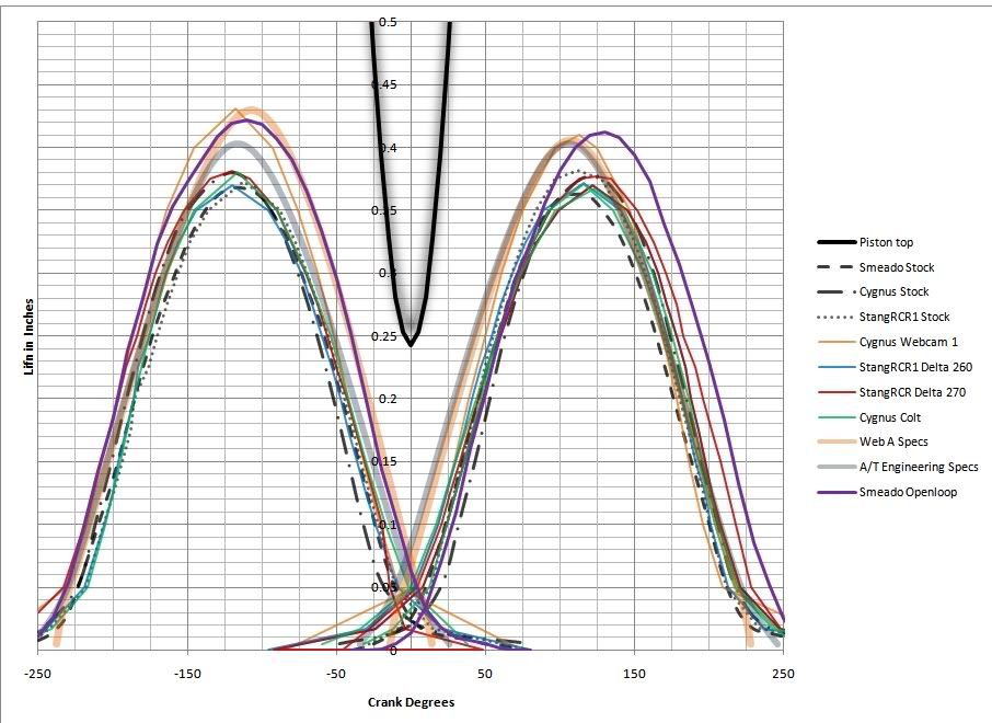

    more info added. bump to see if anybody here want to help contribute to the resource.
    take care,
    Smeado

    What's the light blue one?
    23
    Re: Various A-series Cam Grind Specs
    delta 270... sorry the legend got cutoff

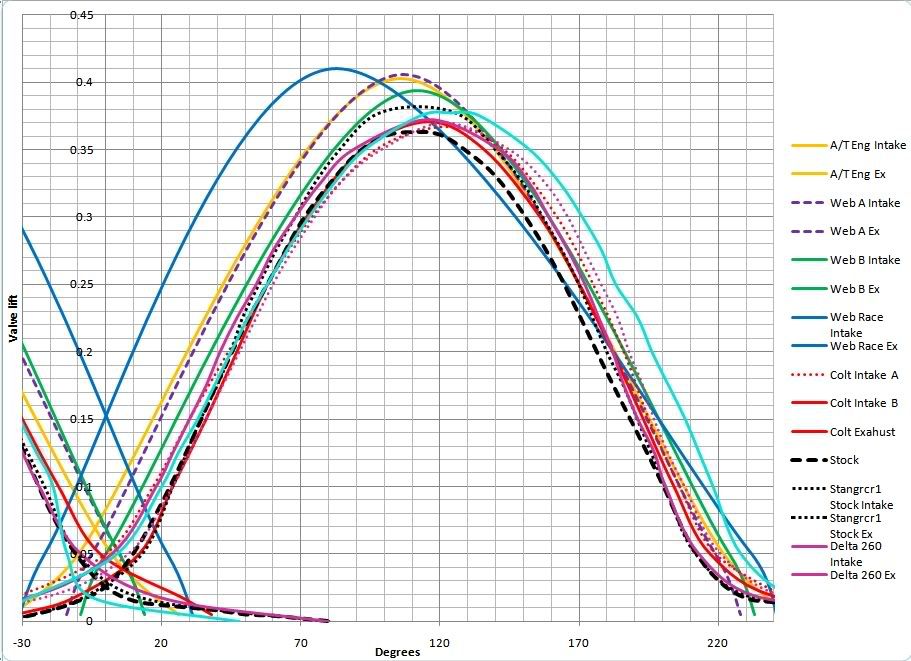

    just a little update.. here is my latest version of the graph.
    all cams are graphed form actual measurements except the A/T cam since i wanted that for my own reference and the Web A so i could compare it with the Web A that Cygnus measured to see how the specs and measurement lined up.
    if anybody has a cam that they want to measure with a micrometer and put on the graph i will gladly take the data and add it.
    Cheers,
    Smeado
    PS thanks to justanothermike for the openloop cam.. it is quite nice
