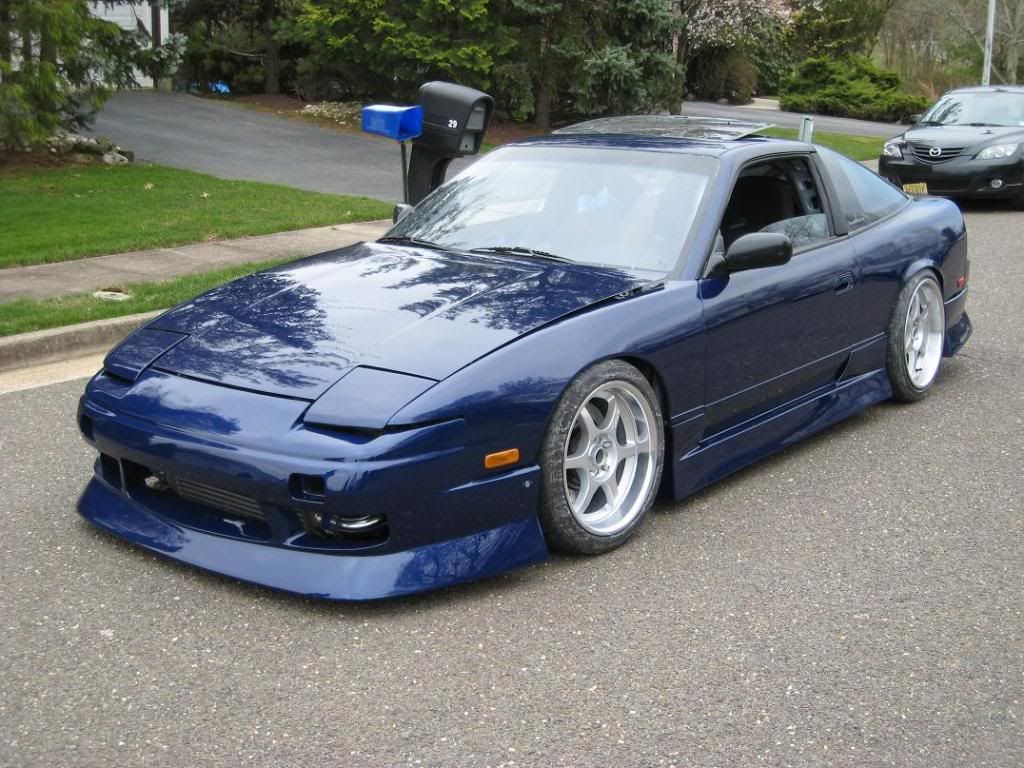

    i wish it was but its not, dead dive away was the excess clear i saw built up at the edges of the panels, also i think it was mark that noted that the paint had more metallic in it than the normal Seattle silver.
    probably after the winter i will end up being able to repaint it unless i can find a decent place that will let me paint it
    Re: wet sanding and polishing
    Haha that makes sense. I don't trust myself wetsanding a factory paint, let alone 20 year old paint. Nice work BTW, and why repaint? It looks fine as it is.
    Yeah it just looks to have a teenie bit more metallic in it than oem, but the color base looks damn near dead on. The fact that you used the Seattle Silver touch-up/retouch paint on that wheel arch, and the very close match, shows it might just be the proper base with just a little metallic dust added to the first clear, or just mixed into the base.
