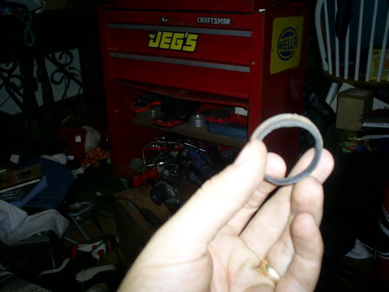

    anyway, the shifter is out, so I can replace the bottom dust seal, plus put in the new poly stuff. I forgot the big inner seal is torn up, so that will be another three weeks before it gets here. I think I can replace it from above. As long as the stuff that has to be installed from the bottom is done, I'm happy.

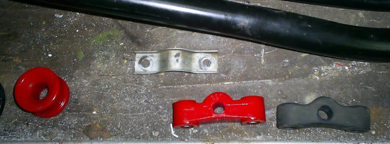

    the new bushings

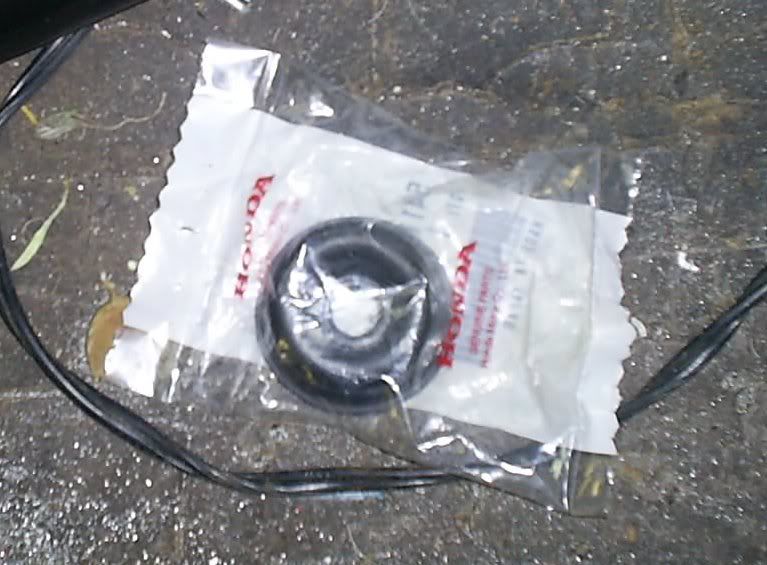

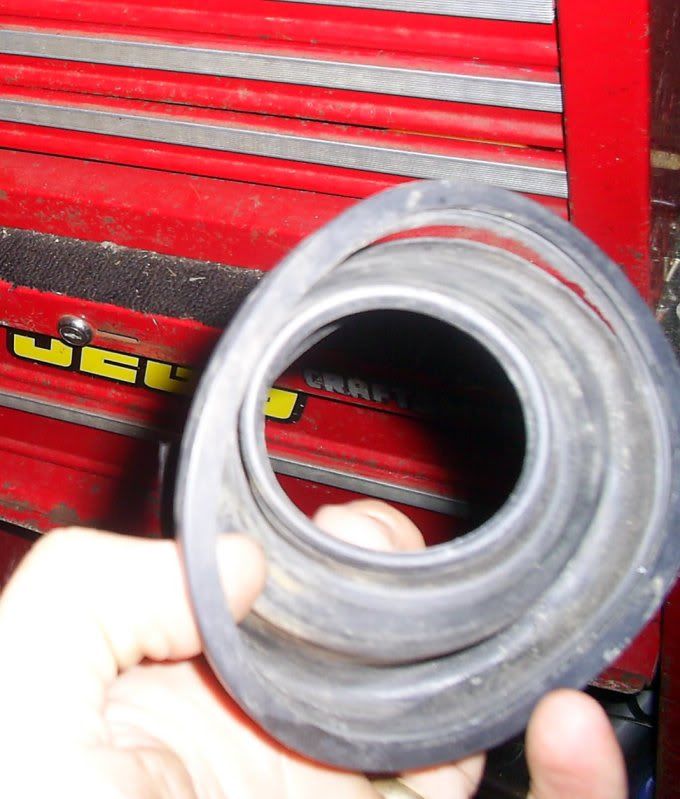

    new dust seal, this is supposed to be the last one in the US
    you can see where it's torn

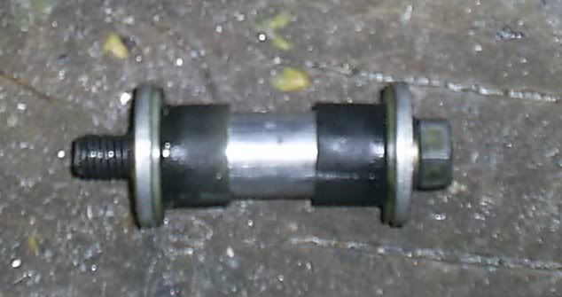

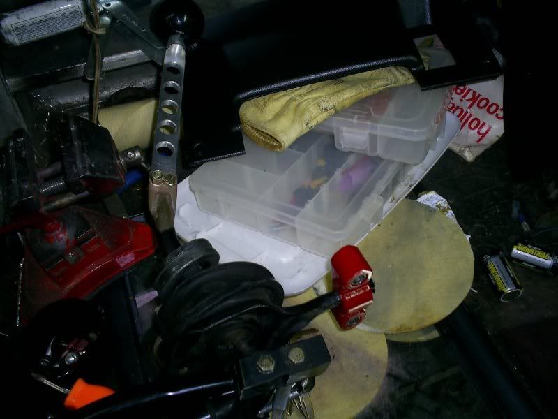

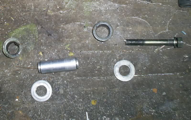

    This is one of the most important pieces I made as far as the shifter, this is the bushing where the shift rod attaches to the transmission, at this junction, you have a large movement of the shift arm, converted into high torque and small movements, any wear here is amplified into a sloppy shifter. I made the stepped aluminum bushing, and a steel washer fits over both ends. I reused the two plastic factory sleeves
    I think you're going to have a very jittery feel in the shifter that way, but rock on dude.
    Re: some shifter progress it's ready to go back in again
    I've been running that piece for several years when the car was on the road and it was great, shifter was nice and tight

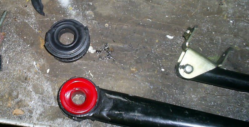

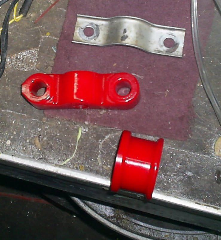

    the energy suspension kit is part number 16.1101R it's a civic kit. you can sometimes find them on ebay. the kit fits the three G perfectly and you can really see a difference between stock and these. It's a little bit of a pain to install the torque rod bushing, but once it finally snaps in, it's a nice tight fit, you use the palm of your hand to push it, then keep working the edges, and eventually it'll pop right into place,

    I finally found the white lithium grease after tearing apart the house, now I can take the shifter apart and replace that bottom grease boot. The one on top looks like it can be pulled out from in the car, just remove the outer boot, pull it out, slide on the new one and attach the lip to the edge of the steel. I never want to pull and install this SOB again.

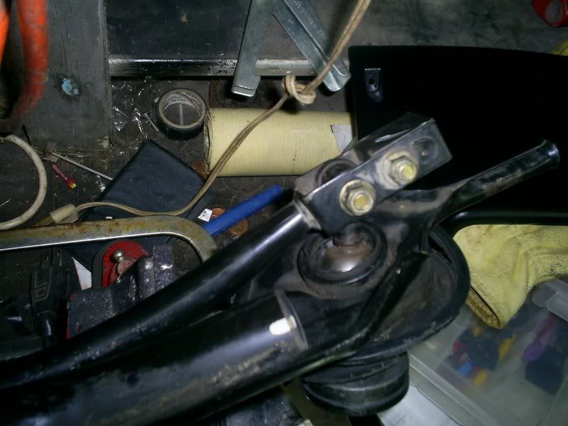

    New dust boot on, this is very important as it keeps crud out of the shift ball area. It was a son of a bitch to get over the piece on the end. when the shifter is assembled, it sits in the hole at the bottom of the assembly, I was going to order and replace everything, but the shift ball cage is excellent, the spacers are good, the bushing at the bottom, the one with the teflon pieces over it, it looks brand new, no up and down movement of the shift ball,no slop. Since the car will be driven as a project car for fun, I doubt I'm going to wear out any of those pieces. I feel better knowing they are sealed from dirt, All I need is the inner dust boot, the big one. it goes in from the top anyway.

    boot installed
    torn up inner dust boot
    I thought this post might be interesting,since most people have never seen the lower dust boot, just the remains of it

    one of them is probably the big bushing in the torque rod, that one in the kit, the other is way up under the car, behind the shifter, it's also in the kit, the entire shifter assembly actually floats, the only solid connection is the one at the transmission. suspect the bushing between the shifter itself and the shift rod, and the bushings, sleeves, in the connection to the transmission, the transmission one made a big difference driving it, even without the other bushings, I can't remember exactly whats in the stock bushing, mine uses the factory plastic sleeves over an aluminum bushing , there are a lot of plastic parts that can wear. you might have wear in the ball cage or seats, most of the parts are available, one thing is DON"T loose the metal piece over the rear shifter bushing. It's discontinued. most of the parts are pretty cheap, but you may have to wait a while, I know I got the last lower dust boot in the US, he said he could possibly order more but they have to come from Japan. Best to order everything and rebuild it while you can. the bushing connecting the shift arm to the shift rod is designed for some play, it's a metal sleeve with grooves cut in it and o rings down it's length, and two graphite bushings over it that snap in place. I think the O rings are supposed to give to prevent grinding into gear for bad drivers. I will be able to make a solid bushing to replace it if it gets discontinued One thing is when you drop the shifter, disconnect the downpipe and lower most of the exaust, the two nuts up under the heat shield are nearly impossible to reach otherwise. make sure you loctite those nuts, they will be a real pita to replace if they fall off. when you install the rear shifter bushing, you will need to transfer the two metal sleeves from the old one. the entire shifter floats under engine torque, when the engine rotates on it's axis, the shifter torque rod rotates and actually moves backwards, as well as the entire shifter. the entire thing is hung on a pin in the rear bushing, the bushing is bolted to the rear of the shift assembly plate, which is bolted to the tunnel. as the engine rotates the entire shifter slides back and forth on that pin. If one ear of that bushing is broke you would have terrible movement of the shifter.

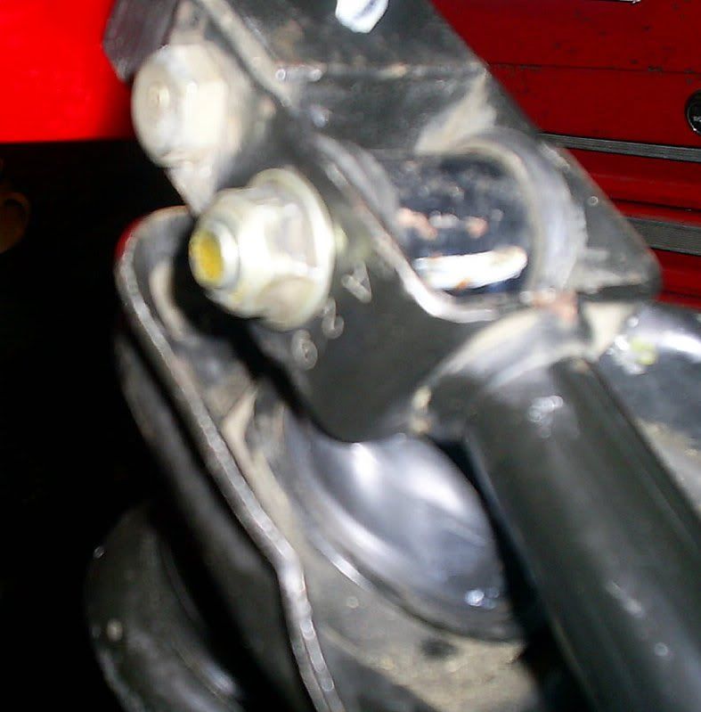

    the entire weight of the shifter,plus the shift rod, and the torque rod, is on this one bushing, the center hole in it. I could see a stock ear breaking after 20 plus years

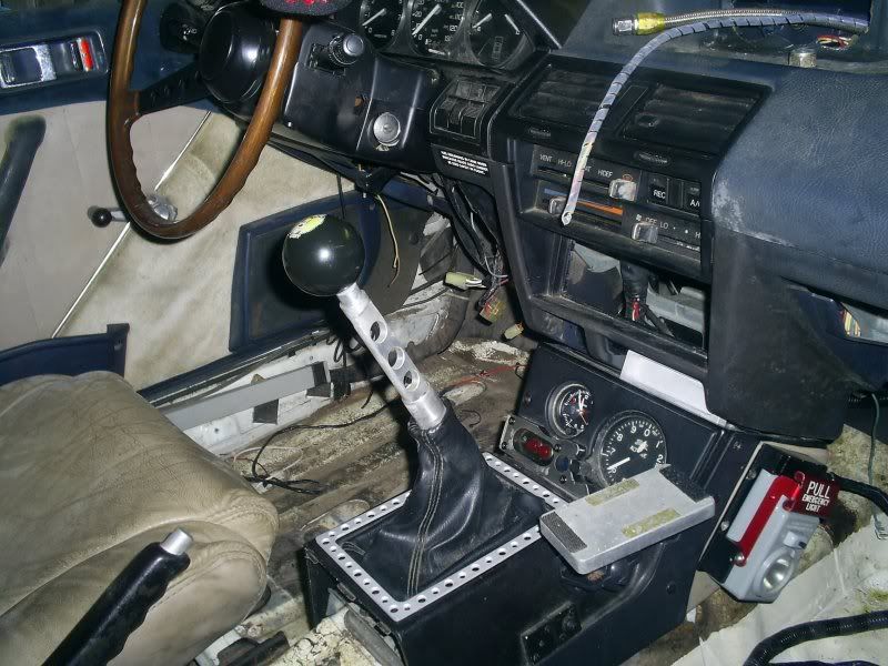

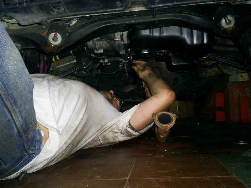

    the shifter feels great, no slop or anything, can't wait to get it done and drive this thing, next is the set of pedals i made five years ago, and a new brake booster, or new used one, it may seem like i'm doing things in a haphazard way, but there's a method to the madness, everything has to go in in a certain sequence to prevent it from going in and out 20 times, i had to work on the oil pan, so the cross member was out, while it was out and the exaust disconnected at the downpipe, i went ahead and finished this, while it was easy to drop the exaust to reach the bolts under the heat shield

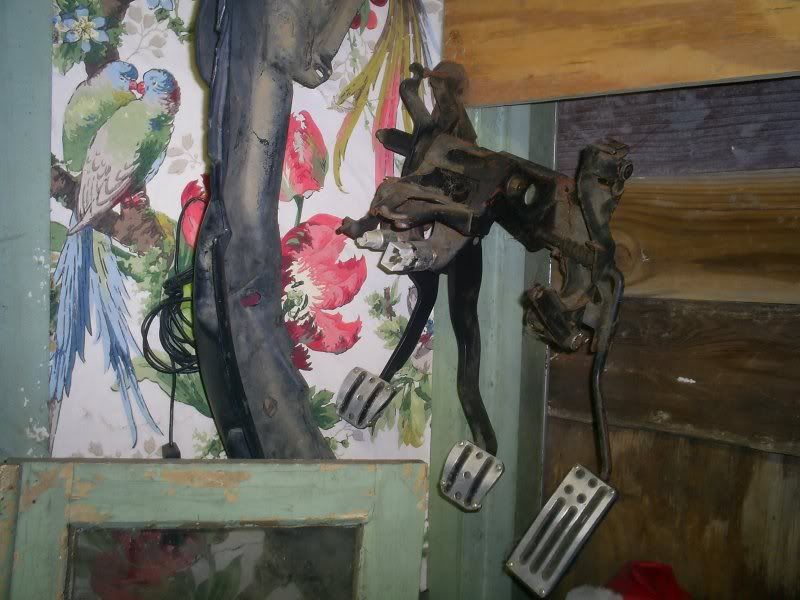

    pedals you made? Got pics of those? Are they placed better than the stock pedals or something? Extra adjustability?

    I'll take some pictures mostly cosmetic is all and i overhauled all the bushings and everything

    Yeah pics would be cool. I've meaning to grab a pedal assembly for modification. I really hate our pedal placement. Especially the way the accelerator sits in relation to the brake pedal. I'd like the get the accelerator to sit higher, and close to the brake pedal. Heel toe down shifting is nearly impossible with the stock pedal placement.

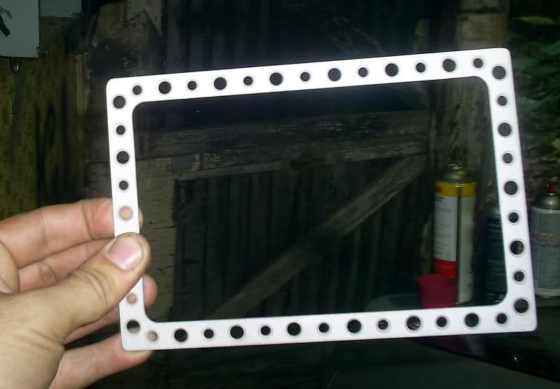

    made this today for this project, didn't use the DRO, just layout fluid, calipers,scribe, and a center punch. I like doing the holes the old fashiond way
    and here are those pedals, they need cleaning up a bit
