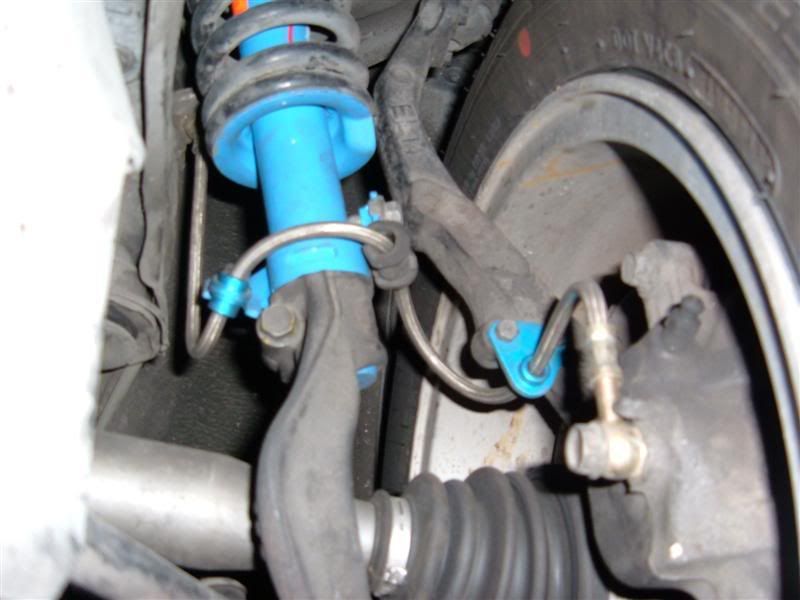

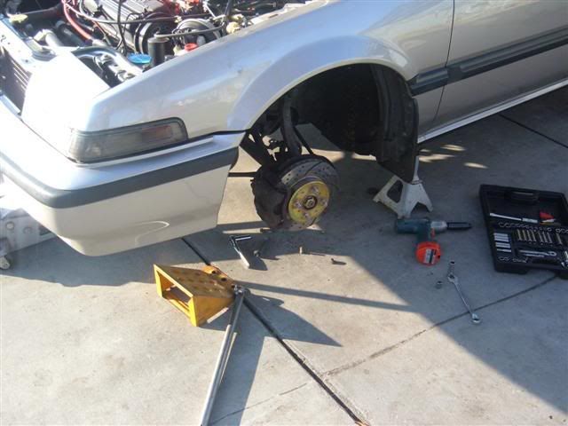

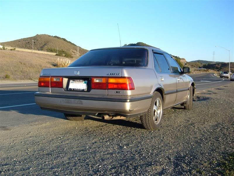

    this is my SE-i/suspension conversion pics.
    JUSTINS rear disks live on the MeSsY HoNDa MoBIle....bwhahahahaha
    jackstands rule!
    ^^^rear
    ^^Front
    fat fives FTW

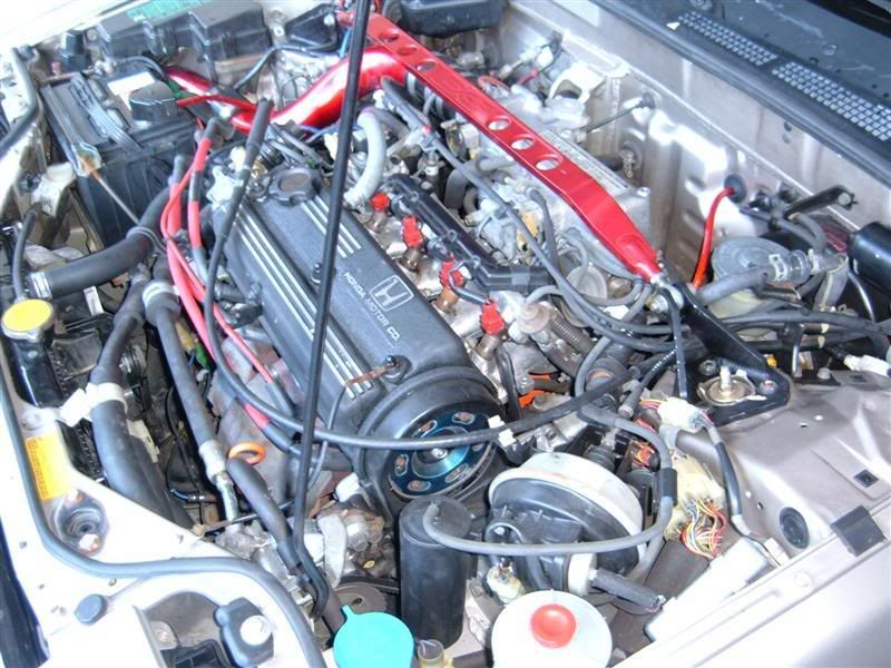

    engine bay...dc sturt bar....rare as fuck!
    looking at its pray...hehehe
    enjoy the pics...

    Hey rides looking good man, you get looked at when you pull over at the side of the road to take pics?

    Nice! gimme those strut bars... and drop that messy honda
    <3 sohc
    Re: SE-I/Suspension Swap.
    yep drop that bitch! NOW yO!

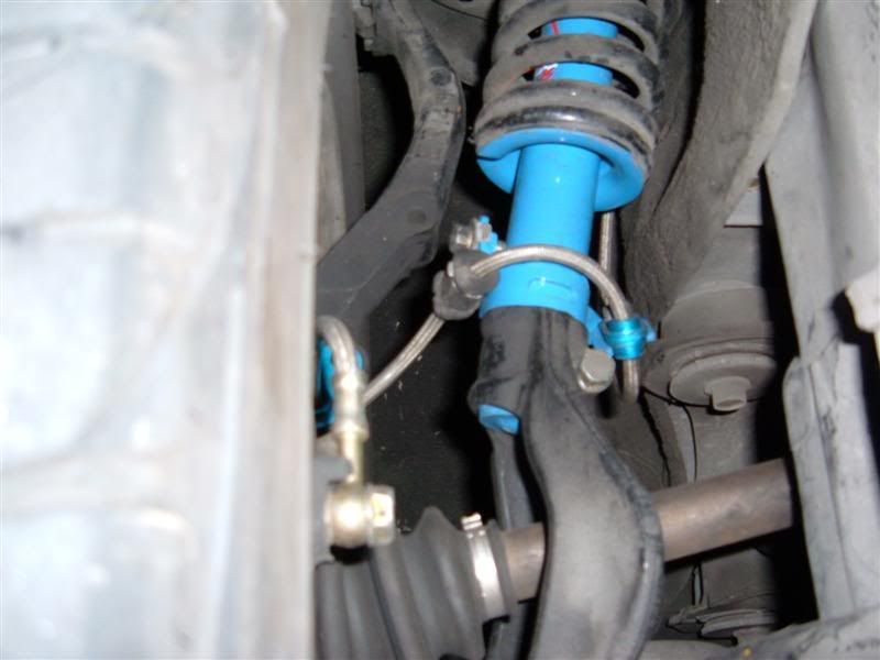

    what rotors do u have on?

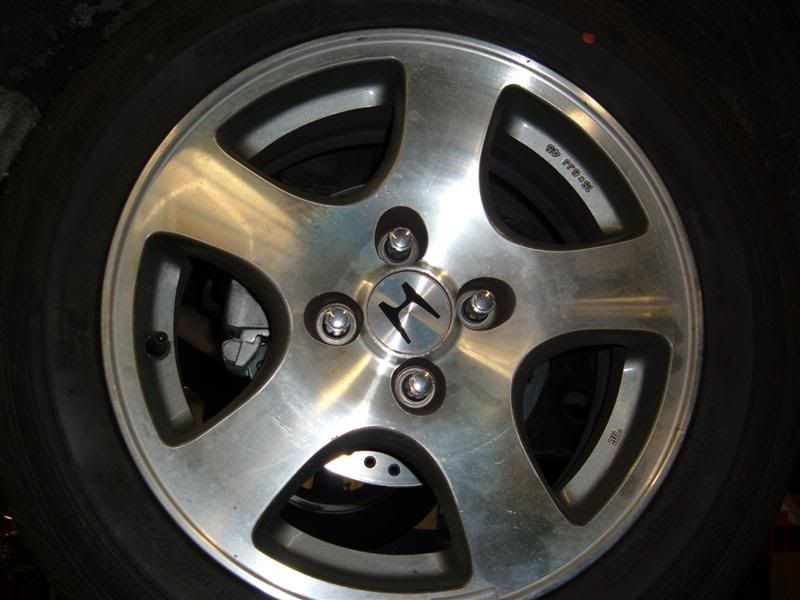

    Front: EBC dimpled and sloted rotors with AEM pads
    15inch Fat fives
    Falken tires 512 195/60/15
    DC front strut bar
    Tokico struts
    Rear: Powerstop rotors with AEM pads
    SE-i SS brake lines
    SE-i rear disk conversion
    Justins rear sturt bar
    some cheapo's? lol
    dude why did you get slotted and drilled rotors? they crack
    cheap? no ebay stuff here maing... and they have not cracked and i ride on them hard.....i lock em up and heat them up alot....and if they crack i would just put in brembos.
    im kinda confused on the parts you need to do the se-i rear discs some threads say different stuff. Can you point out each part you used? Nancy will have rear discs also ...one day
    <3 sohc
    Accord of the Year - 2006
    guaynabo89's Avatar
    FL
    4,144
    Quote Originally Posted by 87lxiaccord
    just the knuckes (dont need whole triling arm) calipers with all braakelines that should already beon th knuckle (hard and soft) rotor, ebrake cables, master cylinder and prop valve
