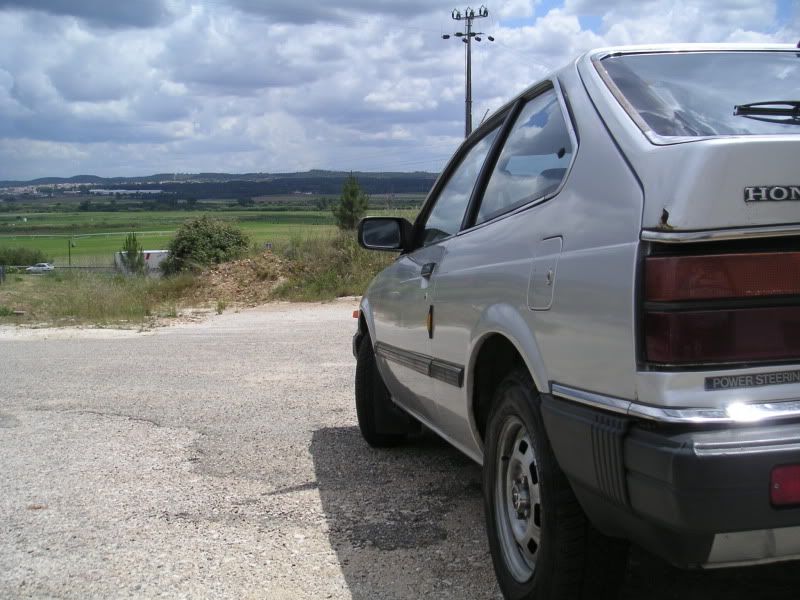

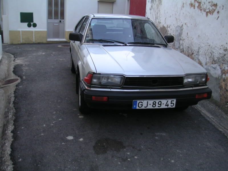

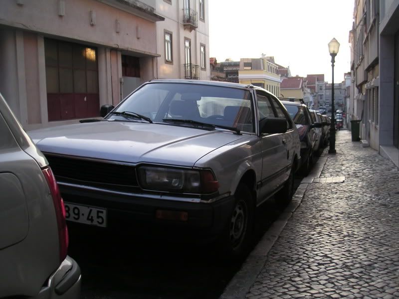

    Hey there, my name is Eduardo and im form Portugal.
    Recently i have bought a Accord Hatchback made in 1982, sold in Belgium and imported to Portugal in 1984.
    This car was wrecked and rusted, the previous owner didnt care to much about him, so i made a ridiculus lower offer and he acepted. The same day the Accord came to the garage to make company to my Audi 80 GL from 1983

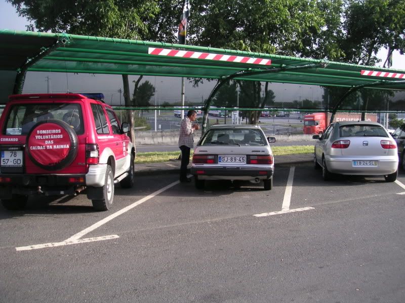

    The car on the first trip to the countryside:
